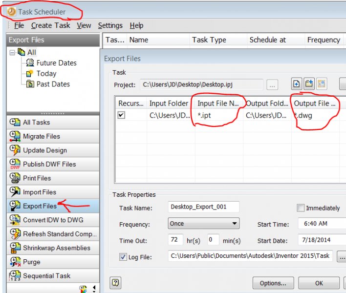

JD Mather
I haven't used this - but did you try the Task Scheduler?
Start>Autodesk>Inventor>Tools>Task Scheduler

lamensterms
Hi JD, thanks for the reply. Pardon my ignorance, but is this a feature of full Inventor or Inventor Fusion? I am not an Inventor user, just the block library I have downloaded is in .IPT format.
