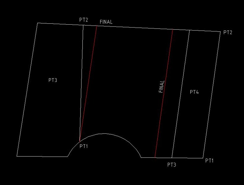

I want to an answer for this question. I am drawing plans for lands using Autocad. then there no easy method for me to partition those lands. Now I am doing this as mention below. first of will the boundary of the land is drawn to make it a closed object. next using a line elevation part of the land is marked approximately. using the the boundary tool the boundaries make for that marked point. after that the area at the point is measured then the calculated area is compared with the original area. if it is not match a grip is stretch in the boundary object. repeatedly this I have to adjust the relevant area. it is not an easy task.
it will be easy if i can do it as given below. when the grip is edited as the mouse pointer if the area is shown it will be easy. be kind enough to left me know if there is any lisp program available.

hi malkasun, no respond maybe members don't understand your request?
can you elaborate more or attached a drawing with comments?

Hippe013
If I understand correctly you are looking to adjust a parcel (boundary) area until you achieve the desired area. This is a command in Civil 3D called swing line or slide line under the parcel layout tools. It is not available in vanilla AutoCAD. I haven't come across a lisp file for this process and writing one would prove to be somewhat difficult.

BIGAL
It is achievable for a couple of simple shapes a parrallel line with say 4 pts moving the line iteratively along a line at a fixed brg until it gives area with tolerance. Same with fix a pt and swing, the VL-intersectwith will work out the missing pt then just area with known pts. Once curves are introduce yes it beomes complicated except for a few simple variations. Using Bpoly you can get area quickly for any shape. I am pretty sure there is some code out there.

hanhphuc
[ATTACH=CONFIG]50084[/ATTACH]
Thank you for the explain, an image tells more than words :)

BIGAL
Snownut when doing lots you have to enter area required and it just goes bang done, this is the crux of the problem, land development is all based around maximum lots for an area, to manually move is just to hard, Where I am they are down to 300m2. There is probably about 4-5 variations of methods, I posted the two most common. It is much easier to not play with plines using as I suggetsed BPOLY to make final result. If you were doing 10 lots same size its just enter enter 10 times. Its like most things I have access to two software products that just do it.
I know YMG was doing stuff on surfaces again this is please add something else for free that CIV3, Stringer, Civilcad or others do and you have to pay for. If I can find time will have a go.
