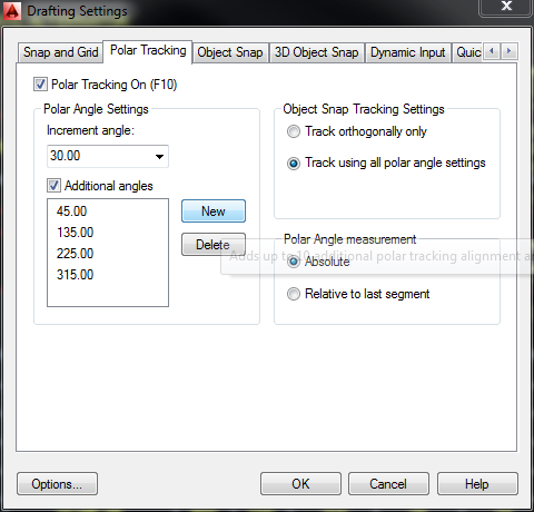

It looks like you are referring to not being able to use polar tracking at a 45° angle. You probably need to add it to your polar tracking settings.

And make sure the Ortho option is OFF when mirroring across an angle. The snap tracking can get weird and it will make it easier to hit your snap point.

I stand by my first response. See attached that 45, 135, 225, 315 all need to be added.

Thank you all for the quick responses! I had seen your answer the very next morning but I had to go to work. When I got home I couldn't log into my account! I finally got my end resolved to answer everyone back. When I first got AutoCAD for the trial, 45° was added in somehow, so I personally never learned what made mirror work the way it did. Adding 45° to the polar tracking did the trick!
