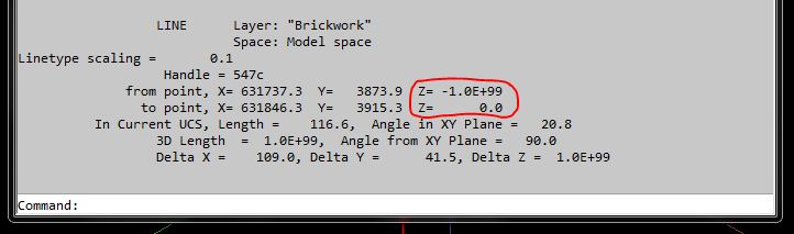

Guitte Posted November 3, 2014 Author Share Posted November 3, 2014 https://www.dropbox.com/s/eoqlt3huclodu2p/FP003-ShpDwg-Zone08.dwg?dl=0 There is a red cloud with an arrow indicating the line. Quote Link to comment Share on other sites More sharing options...
Guitte Posted November 3, 2014 Author Share Posted November 3, 2014 Trim works when changing the z value manually to 0 Quote Link to comment Share on other sites More sharing options...

ReMark Posted November 3, 2014 Share Posted November 3, 2014 Seems Express Tools can only be used in 3ds Max, im using ACAD LT. Express Tools is a feature of full AutoCAD not LT. You might want to -purge (Regapps first; All second) then audit your drawing file. There is something that is not quite right with this drawing. What is the source? Quote Link to comment Share on other sites More sharing options...

ReMark Posted November 3, 2014 Share Posted November 3, 2014 There are three lines on a layer named Brickwork with an unusual set of Z coordinates. How did these get created? Quote Link to comment Share on other sites More sharing options...
Guitte Posted November 3, 2014 Author Share Posted November 3, 2014 Everything worked perfectly, today and a previous time i found that trim and extend gave me hassle. Today i just got tired, cause it became worse in this drawing and want to find out why. Only thing that did work was to select a group of lines change all to have Z to 0. Quote Link to comment Share on other sites More sharing options...
Guitte Posted November 3, 2014 Author Share Posted November 3, 2014 ReMark, i have done the -purge twice and the overkill. No luck. The drawing that you have is not suppose to be there, it is not part of this particular drawing. Z=-1 .E+99 was the macro i was given and that was the outcome. Quote Link to comment Share on other sites More sharing options...

steven-g Posted November 3, 2014 Share Posted November 3, 2014 On the original drawing the objects with odd Z values appear to be the aluminium profiles, did you maybe create those using the array command. The array command does have the option to array in all 3 axis and these objects are spaced out nicely with a step in the Z axis of 577mm between each one, which could explain why it happened. Quote Link to comment Share on other sites More sharing options...
Guitte Posted November 3, 2014 Author Share Posted November 3, 2014 At this stage i have selected groups of lines and went to properties to correct the z value to 0, the micro doesn't work unfortunately. Seems after i have done that it looks good... so far. What makes me wonder is, can someone else's settings interfere with a drawing i created when they want to do some modification? Quote Link to comment Share on other sites More sharing options...
