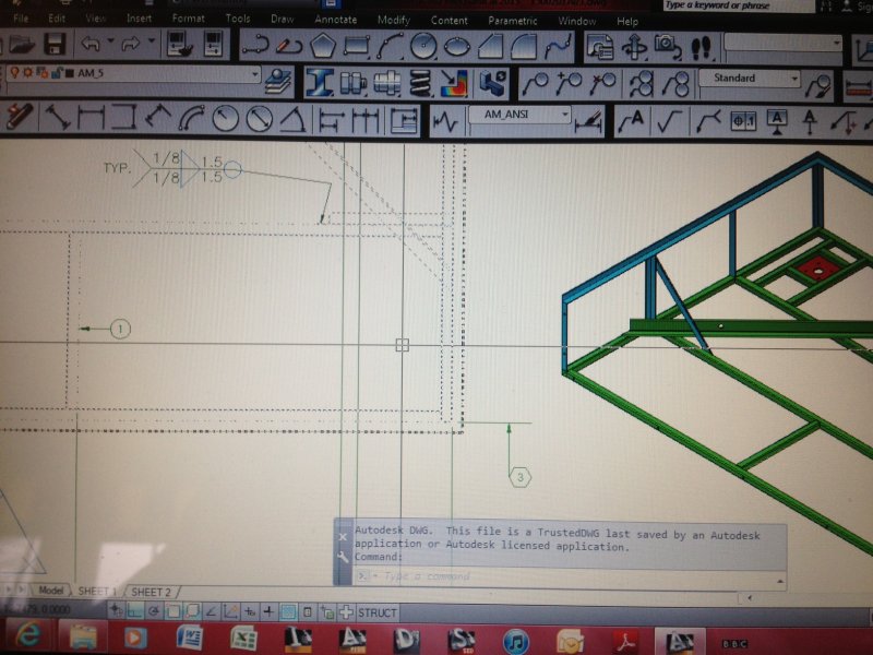

Hello all,
Is there a way to toggle off the VIEWBASE command viewport? When I am working in Paper Space and adding part balloons, notes, dimension, etc. the viewport created with VIEWBASE lights up whenever I hover over it to select something else. Usually I end up selecting the viewport instead my intended object laying over the top of it. Its distracting with a huge assembly.

PGuatney
Dana, I don't think what I am talking about is on any layer. If you hover over say a Dimension line, it will turn to a dashed line so you know you can select it. Same thing is happening with my assembly using VIEWBASE. However, whenever my cursor travels over the assembly, the whole assembly turns to dashed lines with a dashed line border around the entire view as if to select it. My solid model assembly isn't one entity, it is made up of many, so individual parts don't light up, the entire assembly does. (All if this is in Paper Space, of course) So, picking a centerline or dimension line I have just drawn ( In Paper Space, over my VIEWBASE created view) is very difficult because ACAD wants to pick my entire assembly instead of the dimension line I am aiming for. If there was a way to keep my entire assembly from "Lighting up" when I mouse over it, I'd be able to select part balloons, dims, centerlines, etc. As it is now, I often erase my VIEWBASE view accidentally many times during the annotation process of my drawing. UNDO brings it right back, but I sure think I am selecting something other than my view. I can window around something and all is fine, but selecting individual entities over a VIEWBASE view is a problem.

PGuatney
OK, I had to use my phone to take a picture. I need a teenage kid to tell me how to do that. Maybe you can see the dashed lines over the objects. My assembly, not the dims.

ReMark
Yes, you and Dana are talking about two entirely different things. Dana is referring to layout viewports; you are not.
I have been unable to come up with a way to prevent what you are experiencing from happening and have yet to find a suitable answer elsewhere. Tested using AutoCAD 2015.

nestly
If you don't want the Drawing View to highlight when the cursor passes over it, change SELECTIONPREVIEW = 2 at the Command Line or in Options > Selection tab.
If you don't want the Drawing View border to be visible at all, put the Drawing View on it's own layer and VP Freeze that layer.

PGuatney
Nestly, That was the solution! it fixes my whole problem. Thanks for the solution.

PGuatney
Sorry about that.... I used both. the VP freezing and Section Preview in the options dialog box. You have to use both to accomplish what I want. Now, if I hover over the model in Paper Space, it does nothing. If I select it, it lights up. Exactly what I needed. Also, no outline around the "Viewport" whenever I hover over it. I guess it is a viewport. It is automatically generated when I use the VIEWBASE command and it is put on a "VPORTS" layer.
