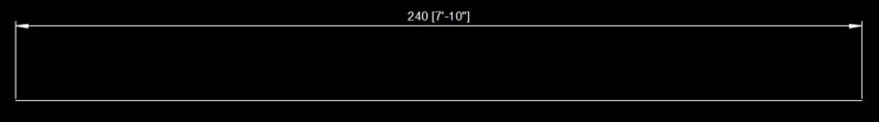

Sbeth85 Posted April 20, 2015 Author Share Posted April 20, 2015 Rkent- Thank you, but I got a little confused about how to it properly. Currently I work in CM. I'd like it to display in feet and inches. Example: 167 cm / 5'6" (as opposed to 167 cm/5.5) Is this possible? Can I have the name of the units show besides it? How do I deal with this multiplier thing? Quote Link to comment Share on other sites More sharing options...
Sbeth85 Posted April 20, 2015 Author Share Posted April 20, 2015 Followup: I've played around and gotten to the point where my measurement will look like this: 240 [7 7/8"] which is the "Architectural" Alt format or 240 [7.82] which is the "Decimal" Alt Format But none of the formats are giving me what I'd really like, which is to see: 240 [7'10"] or better yet 240 cm [7'10"] Anyone? Quote Link to comment Share on other sites More sharing options...

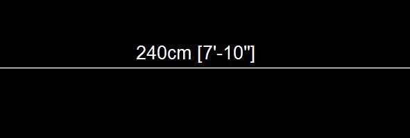

ReMark Posted April 20, 2015 Share Posted April 20, 2015 (edited) Using plain AutoCAD. With the "cm" added as a suffix. Edited April 20, 2015 by ReMark Quote Link to comment Share on other sites More sharing options...

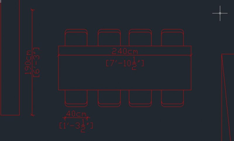

Dadgad Posted April 21, 2015 Share Posted April 21, 2015 (edited) When I need to use and display alternate units, if there is sufficient room in my drawing, I like how they look with the placement of the two above and below the dimension line. In some instances a drawing might be too dense to do it this way, as it does take up a bit more room. This is just a heads-up for another way to display them. Of course, there is another Architectural units display style, called Architectural Stacked, which might be preferable, available in the unit format drop down list. Edited April 21, 2015 by Dadgad Quote Link to comment Share on other sites More sharing options...
Sbeth85 Posted April 21, 2015 Author Share Posted April 21, 2015 ReMark and Dadgad- Thanks for your responses. I've been able to do both of what you've shown (imperial besides the cm and imperial beneath the dim line). The weird thing is that the apostrophe after feet isn't showing up! And since it's in the middle of the measurement it's not like I can add a suffix... how odd! Quote Link to comment Share on other sites More sharing options...
