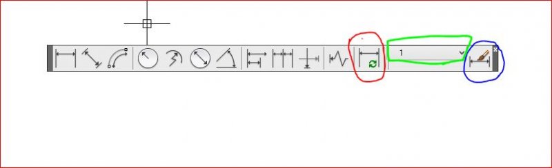

The menu which you describe was actually a list of the available dimension styles which were stored in that particular .dwg file.
It is the Dimstyle Manager, and in order to open it, enter DIMSTYLE at the commandline > (Enter).
Once the Dimsyle Manager opens, you will see listed in the scrollable menu, any and all Dimstyles which are available in that particular drawing.
You can select any dimstyle in the list, and use SET CURRENT to make it your current dimstyle for NEW dimensions which you create.
Doing that however, will not change the existing dimensions in the drawing, without your making it happen.
You could do that with the UPDATE Dimensions icon, which I have circled in red on the Dimension toolbar screenshot, green indicates your CURRENT dimstyle, and Blue is another way to access the Dimstyle Manager.
You can add any dimstyle to an existing drawing in a number of ways.
rkent described how to do it using the Design Center in his post. :)

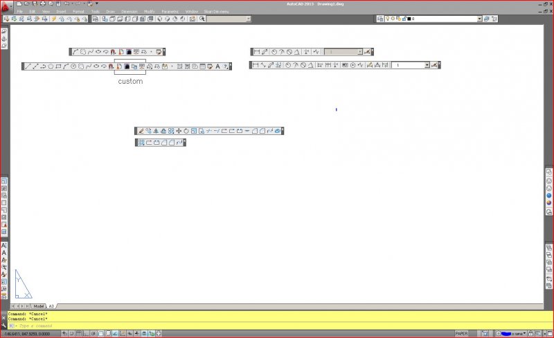

I just used the Microsoft free SNIPPING TOOL to create a SCREENSHOT of my usual workspace, one of a few I have created and saved for different types of work, 3D Modeling, Detailing, Annotating, Checking, etc.
The toolbars which I have dragged down into the layout, show comparisons between the original toolbars, and the leaner versions which I have created to better serve my work, and conserve screen real estate.
I noticed that on the long DRAW toolbar there are four which were not stock O.O.T.B., but even without those, the edited one is quite a bit smaller, and I might actually use ANY of the commands on them.
Come to think of it my LAYERS toolbar is a bit lighter too. I hate constantly displaying icons on tollbars which I suspect I will NEVER use.

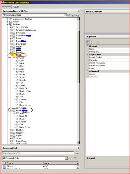

I saved another screenshot showing how to create customized versions of any toolbars you want, in your CUI. By right clicking on the YELLOW highlighted icon for the Modify toolbar, you can choose to DUPLICATE it. Obviously you would want to give it another name, then you can open it, as shown in the screenshot, so you can see all of the icons available on the toolbar. Working on the one which you want to customize, you can then DELETE any icons you might not need, or add other commands, rearrange them to suit your personal preferences.
The MIGHTY EAGLE icon (from Angry Birds) which you see on both of the DRAW toolbars is the image I chose for my OVERKILL button. A great command. The Broom is for a commandline -PURGE , Audit & Save macro.
Once you have created a new toolbar, it will become available in the dropdown toolbar list.
