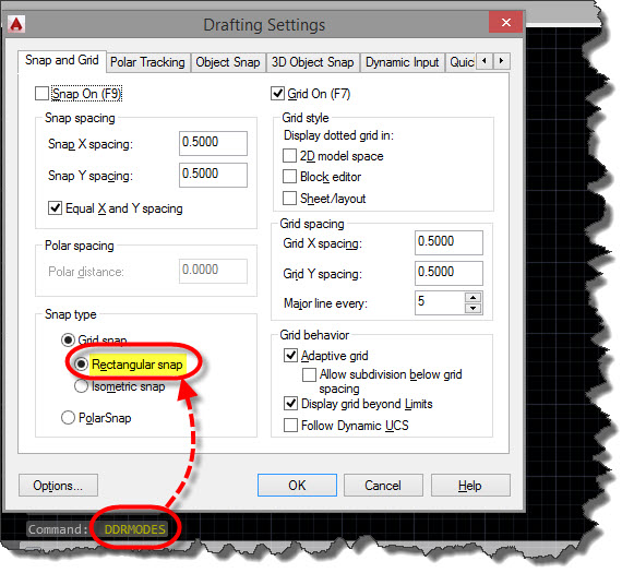

troggarf
I'm noticing that your cursor is at funky angles. Are you working in 3D while also working with Isometric snap turned on?
If that is causing you issues use the command DDRMODES and then switch to "Rectangular snap"
Share this post
Link to post
Sheepdisease
Funny you should mention that, I changed that setting this morning, thanks for the heads up.
