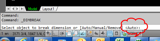

Hi,
I am using Dimension break command and when I click the required dimension, there are three options coming in command prompt ‘auto/manual/remove’ and the default value is ‘auto’. But, in my drawing, I need to repeatedly use ‘manual’ option. But, it is not available as default. If I set ‘manual’ as default instead of ‘auto’, I can access that by again pressing the spacer key. For that, I checked the net and find if any customization is possible. In CUI option, I unable to find out the command prompt customization set up. Then, I search in the .NET programming. There is lot of programming option is provided which I unable to understood. From the help manual, I found that we can upload .DLL files by NETLOAD command. But, I unable to find out the related DLL file for dimension break in my C drive. So, kindly provide any idea to customize the default value in command prompt. Is it possible through CUI method or modifying existing DLL files. If it is possible to modify the default, I can use it for other commands also.
Please find the attachment.
It will automatically default to Auto, which you can set in your dimstyle under "Symbols and Arrows" at the bottom.
