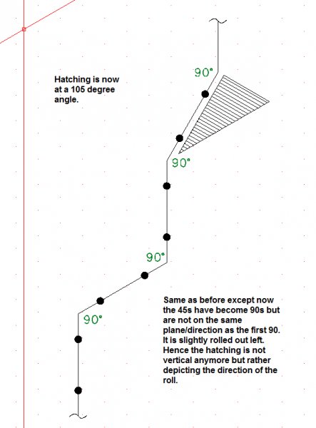

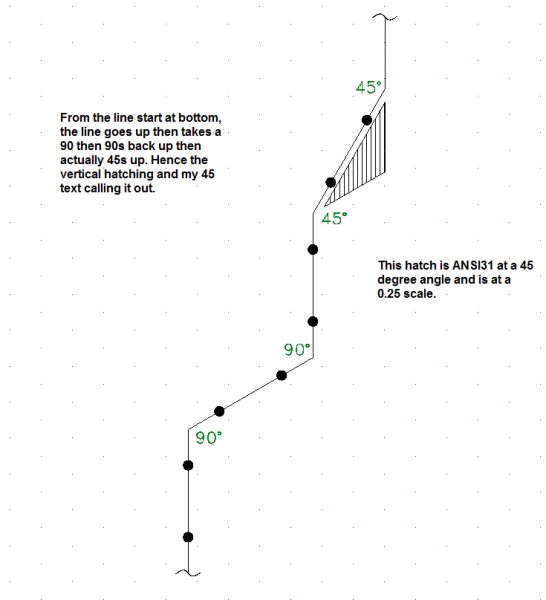

To clarify, right now my office is having to manually draw the right triangles (i.e. using simple line command or offset command) and then we apply hatching depending on whether the angle is a vertical angle or a horizontal angle.
My question pertains to a lisp that can automate the creation of the triangle and the hatching ( I should have been more specific in the title, but thats what AutoCAD Plant 3D calls it). We can manually draw, trim and hatch these all day no problems as this is rudimentary cad operations, however. The downfall is when you have dozens of angles throughout a piping circuit and have dozens to complete each day.
I need someone to help with a lisp routine to automate the triangle and the hatching in a click or two. Heres a screen shot from my program to show example. The first image was taken from AutoCAD Plant 3D and was just for reference.

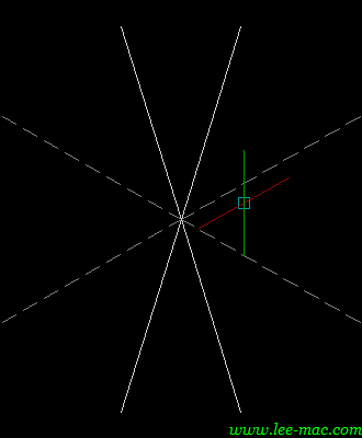

A Quick Demo:

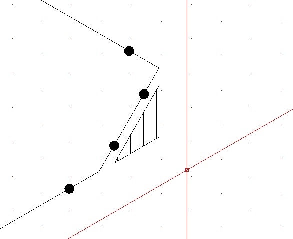

Humm I tried your code lee. I am selecting both end points of the line I wish to create the hatched triangle for but keep getting the message- "Cannot generate triangle for isometric angle."... In our industry we draw strictly in isometric and these are indeed isometric angles. However, when I draw lines straight up and straight right(90 and 180 degrees) then run the code and pick my two points, it pops in a isometric triangle like what is shown in the image that I will attach.attachment.php?attachmentid=55717&cid=1&stc=1attachment.php?attachmentid=55718&cid=1&stc=1

Looking at your results, you will probably need to reduce the triangle offset specified at the top of the code.
I have added a GIF to my earlier post to demonstrate how the program should operate.

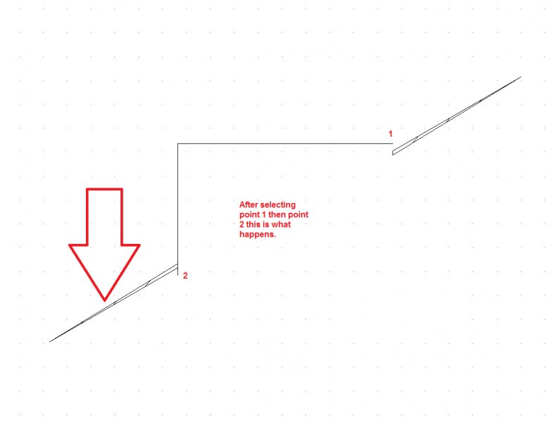

For some reason when I click the second point on the end point of my line is gives me the error "Cannot generate triangle for isometric angle." However, when I click just shy of that end point it generates the triangle? Any ideas as to why?

Yes, the triangle cannot be generated for multiples of 30 degrees, as the baseline of the triangle will run along these isometric lines, however, I realise I should remove 60 degrees etc from this restriction.
