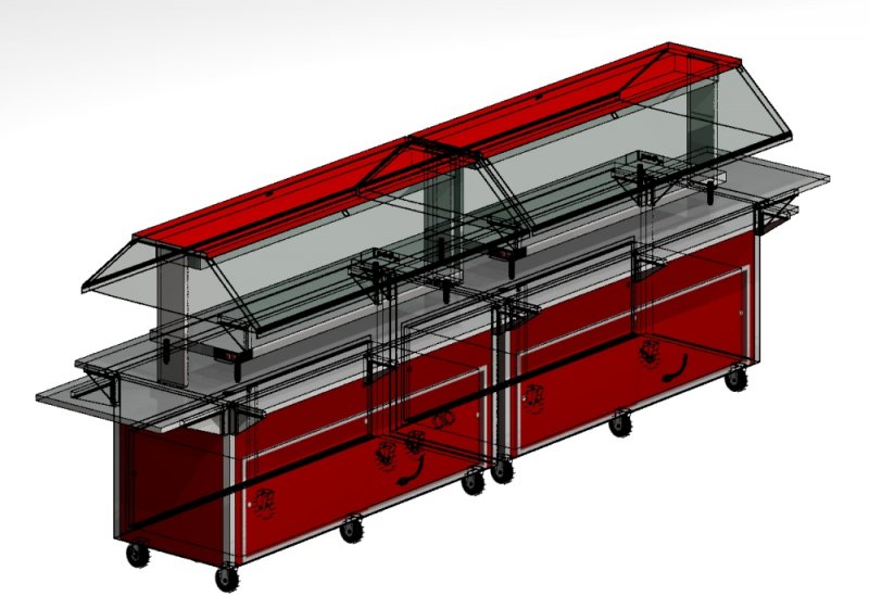

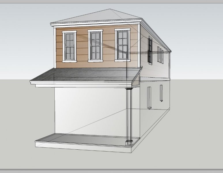

Hey guys,
I used to produce these transition renderings with Navisworks Simulate 2013 (presenter).
We have now upgraded to Navisworks 2015, and of course - the presenter tool has been removed.
Just after some suggestions for alternative software that will produce nice hidden wireframe renderings to superimpose over the regular shaded renderings (I use Photoshop for the superimposing).
Or if anyone knows what this rendering style is called - to make the google-ing easier.
Thanks a lot for any help.

You can do it in Photoshop as well. Use 2 images, 1 wire frame and 1 shaded. Use the same view. I think you use a gradient fill as a mask. I have done it before but not in a long time.

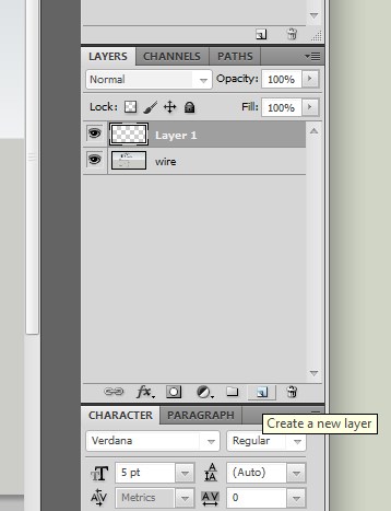

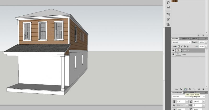

f700es

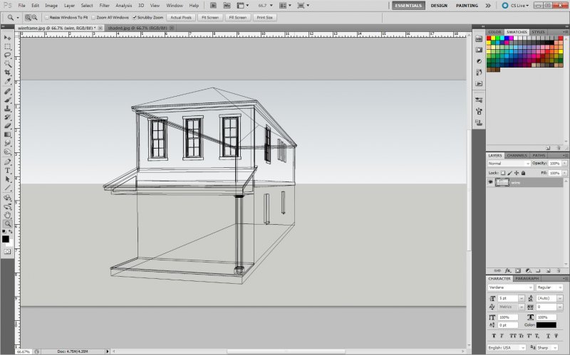

Should be able to David. Here is how in PS...
Make your 2 images..
1 wire frame and 1 shaded (or rendered)
Open the wire frame in PS.
Create a new layer above this one
Open the shaded view and then copy and paste into the new layer
Add a Layer Mask to the shaded layer
Make sure the colors are set to white over black and then select gradient fill and drag from left to right on the image. You can re do the gradient fill until you get the desired effect.

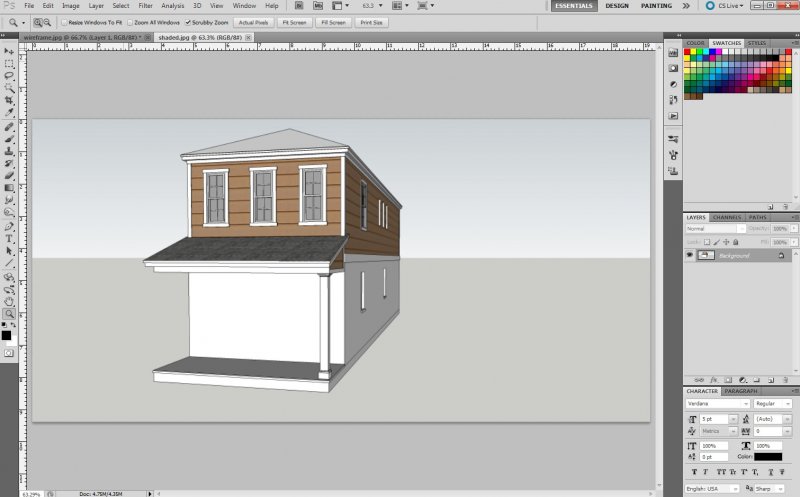

David Bethel
Very cool! The tutorials for Gimp use a similar procedure.
-David
Share this post
Link to post
David Bethel
Gimp 2.8
As you can see I am NOT very proficient at this
-David

I used Accurender to produce the serving carts renderings. 1 with surface model, 1 with all edges converted to traces.

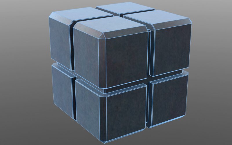

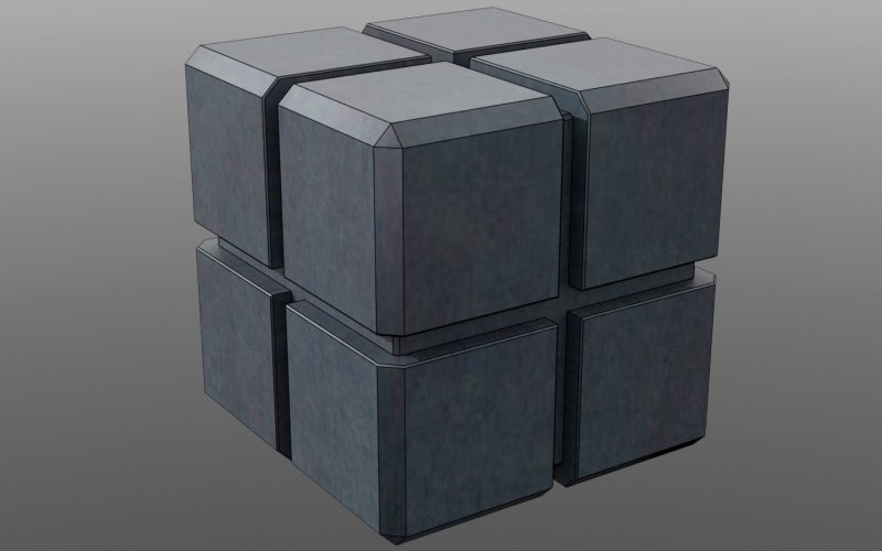

Cad64
The beauty of Navisworks' Presenter was that it was really easy to use (with existing NW knowledge). All I had to do was present a view, apply some materials and export a rendered image.
CAD64 posted earlier and mentioned Modo, which seems pretty high end, with a pretty steep learning curve. That post seems to have been deleted now though.
Yeah, I posted but then deleted it because I figured it probably was too high end and therefore not really relevant. But in my opinion, the learning curve for Modo is really not steep at all. Modo is really user friendly and pretty easy to learn. The renders below were created by simply applying a 'Cel Edges' material and doing a few simple tweaks of the settings to adjust color and edge display.
Share this post
Link to post
Cad64
You can also achieve this sort of look in Studio Max with the Ink 'n Paint material: http://docs.autodesk.com/3DSMAX/13/ENU/Autodesk%203ds%20Max%202011%20Help/files/WSf742dab0410631334fd1fb1c112a1ce99ff-7f48.htm, but with Studio Max, now you really are looking at a steep learning curve. :cry:
And to answer one of your original questions, this type of rendering is typically referred to as Non-Photorealistic rendering, or NPR Rendering because your images come out looking more Illustrative or Cartoonish.
