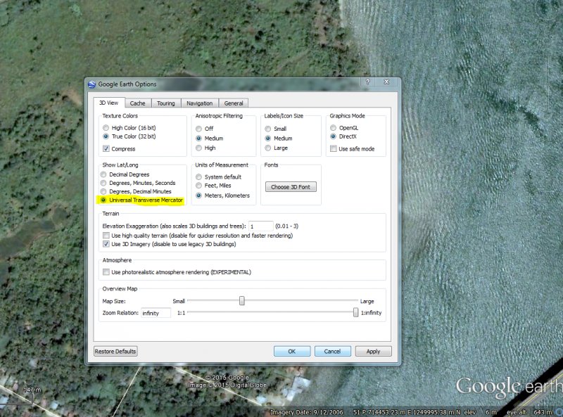

eldon
If you have taken off the Latitude and Longitude by picking points on Google Earth, I would suggest that you have the coordinates showing as Universal Transverse Mercator before you pick the points.
That would allow you to use ordinary style coordinates in AutoCAD without the hassle of spherical projections.

Subiran
After setting it to Universal Transverse Mercator, in AUTOCAD, how can i get the right format to plot like @{distance}

eldon
With UTM coordinates, I would draw the lot by entering each coordinate in turn, rather than drawing it by relative coordinates.
