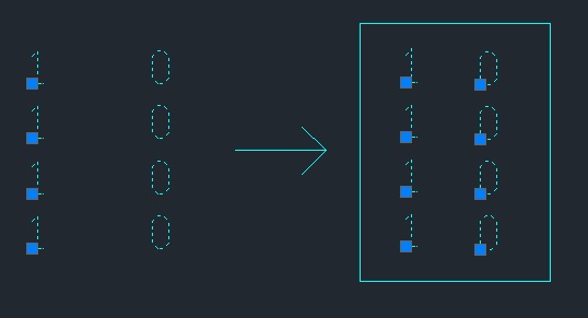

Currently, I have an Excel table. Numbers of column contains 0 or 1.
I have to copy column by column into notepad and then copy the notepad contain to CAD.
After that, I have serval individual column of Mtext. Then I further explode them into text.
A numbers of individual text are pasted on CAD and this is what I want.
However, if I do copy multiple column into notepad, the result is a whole Mtext which is containing all columns. I explode the Mtext and I will obtain multiple line of text.
I am searching for a lisp to convert/separate Mtext to individual text.
For more advance, I want these 1 and 0 located in different destination point from excel to CAD by a lisp.

I found this somewhere, the user copies text from Excel or Word for example. The user invokes the PSTSP command & the text gets pasted as individual text items. I've changed it slightly to capitalise the text:

CloudJack
Thank you!
However, I would like to do this:
If I copy muliple column in Excel, the result is left one.
I want the right instead of left.
Each 1 and 0 should be seperated text.

I found Lee Mac: http://www.lee-mac.com/readcsv.html and I am successful to use this to make as individual text.
