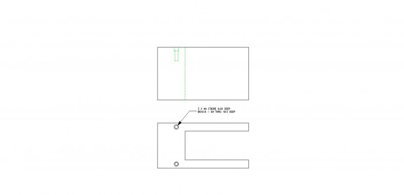

3Ddesiner1960 Posted January 29, 2016 Share Posted January 29, 2016 (edited) I am long time user of AutoCAD for 30 year and now witching over to Solidworks and converting old CAD file to Solidworks. I have used hole wizard few times and still having troubles with it. I having problems with hole wizard. I am using mm and trying to get the countersunk and threads called out, but I have to create in hole wizard counter sunk hole then using hole wizard again and add threads. So I am using the hole call out twice?. what if I wanted it all in one call out and I don't want to manually typ it in. In hole wizard not sure what to put in custom size without Call out giving me more info then what I want. See sample. Edited January 29, 2016 by 3Ddesiner1960 Quote Link to comment Share on other sites More sharing options...
shift1313 Posted January 30, 2016 Share Posted January 30, 2016 I'll look into it when I get a chance but off hand I dont know if there is a thread option for a csink hole. You can however add a thread callout from the insert menu after you make the hole. Also if you have sw 2016 there is a new thread tool that lets you cut physical threads as well as the callout. You can also insert the callout in a drawing after the fact. Quote Link to comment Share on other sites More sharing options...
shift1313 Posted January 31, 2016 Share Posted January 31, 2016 I took a look at this. The best way to do this is to use the hole wizard for your Cbore hole, then Insert>Annotations>cosmetic thread. this will allow you to add a thread to the bore portion of the hole. Also if you pattern the hole wizard hole it will take the thread callout with it. If you have a non standard pattern you can create a sketch with sketch points for all the other locations(skip the "seed" location) and use a sketch based pattern. let me know if you need more clarification. Quote Link to comment Share on other sites More sharing options...
