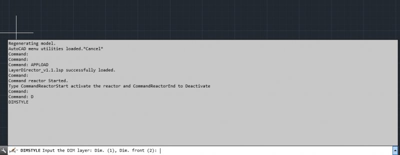

Tharwat
Are you making Linear or Aligned dimensions or anything else ? list them if not too much.
You did not get my point. run my codes then write at the command line in AutoCAD d and hit enter.
Share this post
Link to post
DesmetMartin
I use mostly Linear, Aligned, continius, diameter, radius and angular.
(So the most common things).
This is what I get when running the 'd' command.
Sorry if its hard to communicate, I'm doing my best.:( :)
Share this post
Link to post

Tharwat
Try this with the four options and let me know.

DesmetMartin
Alright!
Now it work :)
There still is something but it's probably hard to fix.
You don't have to do this, you helped me already this much.
I've noticed that when you select another dimstyle, it doens't change.
You have to select the DIM and change the dimstyle when placed.
If you know what I mean? :P

Tharwat
Happy to help :)
What do you mean by select another DimStyle and it does not change?
