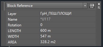

Grrr
I've followed the steps Roy mentioned on my Acad 2015, and can comfirm this:
This is not the case in AutoCAD: converting one of the dynamic block references has no effect on the others.
Seems that it adds new block definition, under the provided name:
(vla-ConvertToStaticBlock o "ABC")
But, when I try to convert other block reference under the same / existing block definition name, I get:
_$ (vla-ConvertToStaticBlock o "ABC")
Error: Automation Error. Duplicate key
_1$
But/And It creates an annonymous block definition anyway:
_$ (vla-get-EffectiveName (vlax-ename->vla-object (car (entsel))))
"*U117"
_$
Note that the "Name" property row in the quick properties dialog, always references to the block's "effective name / definition name".
So thats why my previously posted code forces the creation of N annonymous block definitions:
(ErrCatcher 'vla-ConvertToStaticBlock (list o (vla-get-EffectiveName o)))
Since this always triggers an error :roll:
