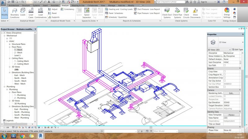

Hello everyone . I am a newbie here new to this forum. Please help me with this small issue . I have attached my revit project file. Im completely new to revit , just installed yesterday. I cannot get the flowrate in the main ducts TO and FROM the AHU. But I am getting flowrates in all other branches .

Please open the above file as project file to edit and see the things inside. I tried adding and removing the ahu to return and supply systems. any ideas?

Blue is supply , pink is return. Please tell me the flow configurations for AHU , VAV , and Diffuser connectors

SOLVED IT GUYZ. showed disconnects in the analyze tab helped me
