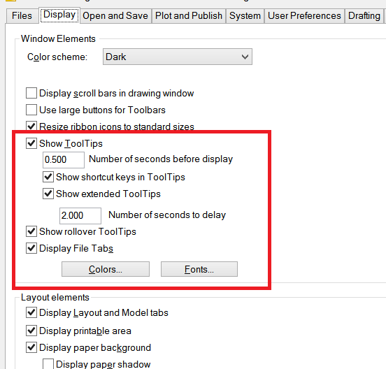

Using Autocad MEP 2013, been using this software for 4 years now and had always received rollover tips (quick properties) by placing the cursor over an object.. For some unknown reason it has stopped doing it. No settings were changed.
What does this part of your Options dialog box look like?

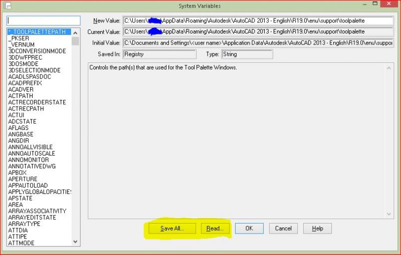

It is a good idea to save a .SVF, so that you can very easily reinstate your personal system variable settings, share them with a coworker, or install them on another computer.
In the SYSVDLG dialog box, you will find the SAVE ALL button at the bottom.
Name it accordingly, and save it somehwere you will be able to access it, for the next time something inexplicably goes south.
In order to call up your personal .SVF, click on the READ button, then Browse to the one you saved, and select it.
If you just click on the READ button, all of the default system variable settings will be restored, without any personal customizations.
