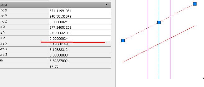

andrew239 Posted September 5, 2017 Posted September 5, 2017 Good afternoon, I am having a problem lately where every now and then i cannot pick up an intersection snap point. I thought the Z values might be different, but they are all at zero. To further complicate things, i can use one of the lines to trim the other, but still no intersection snap is there. I can run the FLATTEN command, and that will allow the intersection (sometimes i need to run it twice). It is confusing, as the flatten apparently fixes the problem, but according to the properties pane, there was no problem with the z value. I have attached a small drawing showing the problem. thanks intersection prob.dwg Quote

maratovich Posted September 5, 2017 Posted September 5, 2017 You use inches. Inches do not give an exact result. Run the command : _units Set the format to Decimal Set the accuracy to 0.00000000 Quote

Cad64 Posted September 5, 2017 Posted September 5, 2017 that did not seem to work. Any other suggestions ? As maratovich described, your lines are not all sitting at Z0. The magenta and cyan lines are at Z0, but the red lines are at Z0.00000024. That's why the intersection snap is not working. When I run the FLATTEN command and select the red lines, they are sent to Z0 and the intersection snap works as expected. Quote
andrew239 Posted September 6, 2017 Author Posted September 6, 2017 a-ha. Thanks for the clarification. I was only getting half of maratovich's suggestion. I see it all now. Is there a variable that will change the sensitivity of the snap (similar to the HGAPTOL). Seems weird that they are close enough to trim with, but not get the intersection. The apparent intersection did work, but i just wanted to find out what was going on. Thanks again. Quote

andrew239 Posted September 6, 2017 Author Posted September 6, 2017 Couldn't agree more. Kinds feels like i am being judged lol. In my defense, this is a problem that has arisen only in the last couple of weeks. All of the problems are contained in files that are brought in from an outside source, typically these are architectural floor plans which have been drawn using Revit. I know very little about Revit, so I don't know if it is some issue with the conversion to a dwg file, or if it is just some intrinsic data in there that carries over. Now I know what the problem is, I have suggested we now flatten and overkill everything before we bring it into our drawings. At any rate, i really appreciate the help. Quote
