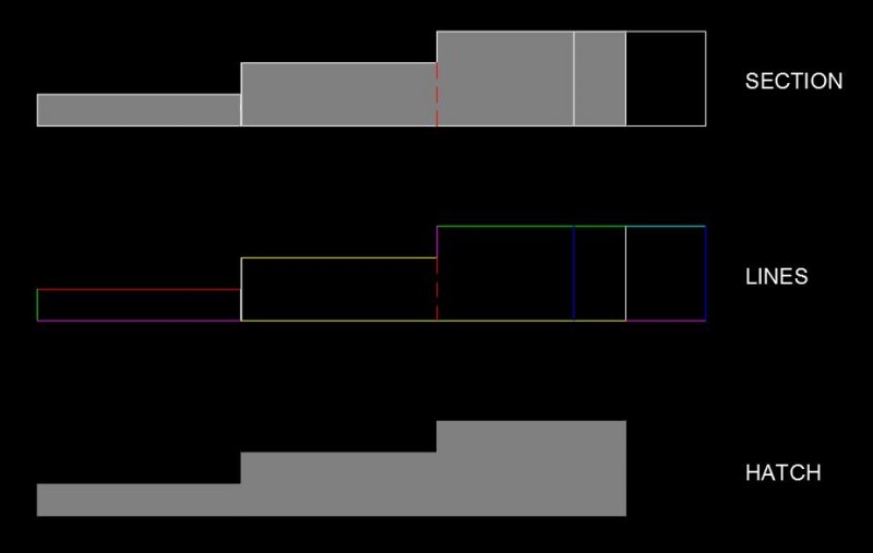

I'm not all that familiar with SectionPlane but what if you were to explode the section? Wouldn't you then end up with lines? A simple example:
The object at the top is a section created using the SectionPlane command.
I copied the object then exploded it.
The middle set of objects turn out to be all lines. I randomly assigned some of them different colors to prove they are individual entities.
The bottom object is a single hatch entity. Normally this would be erased to reveal the lines. I retained it for demonstration purposes.

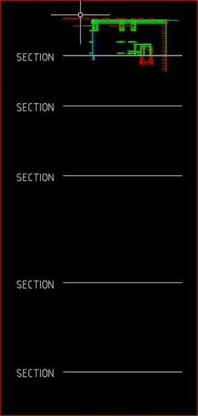

gegenytibor
Thank you Mark!
Here is the link:
https://we.tl/WdwdB5M2FZ
there are 5 section sign what I need.
I need only the parts before the section.
I can delete the red lines behind the section line (they are lines) but allways shows the parts behind the section line as well....
If you can help please check.

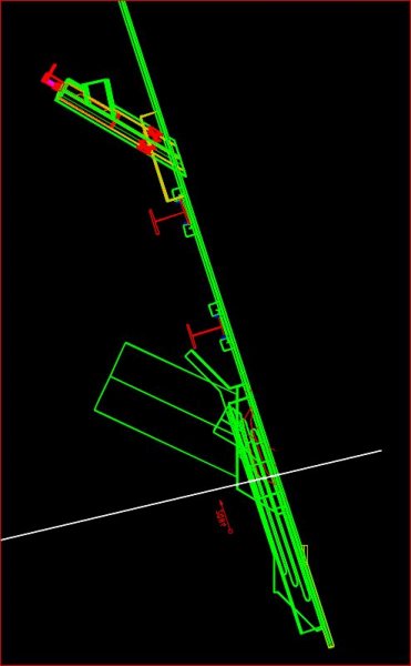

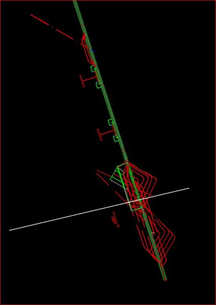

OK. I try to make it clear.
I have a topview from a modell in model space and i need vertical sections at the marked points. (1.jpg) I need this section with 2D lines becouse I have to work forward with it.

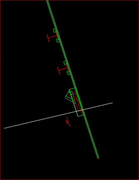

If I make a section plan the red lines stay behind the section line (because they are 3D polylines). (2.jpg)

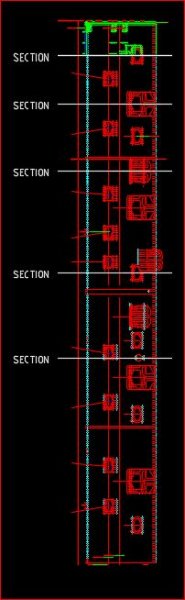

On the layout i make a view what I need. (3.jpg)
But this view shows all the red lines behind and fron of the section line.

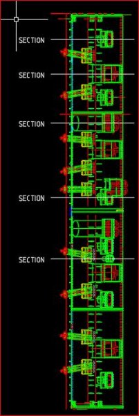

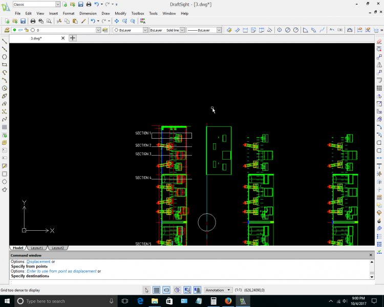

I delete manualy the red lines (4.jpg) and get the section view on the layout what I need. (5.jpg).
I made an exportlayout from this layout to get 2D lines from this view but it shows everithing not just the front of the section part. (6.jpg)
And they are 3D solid. compare the 5.jpg with 6.jpg...
Any idea to get the 5.jpg in to 2D?

ReMark
Freeze the layer that the 3dpolylines are on.
Where did you get the idea that using EXPORTLAYOUT would create 2D lines from a 3D model?

SLW210
Try using solview and soldraw.
