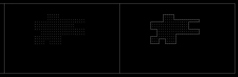

How to draw the boundary(or maximum outline) of a point set?
zixuan203344
How to draw the boundary(or maximum outline) of a point set? Require all points to be on the outline or inside the outline
By looking up academic materials, it seems to be a concave hull algorithm。
concave hull
Share this post
Link to post
marko_ribar
Are your points like in the picture - spaced like grid and should boundary always be orthogonal like in your picture?

zixuan203344
Thank you for your reply.
This is just a special case. Not all point spacing is equal. I want to find a general method.

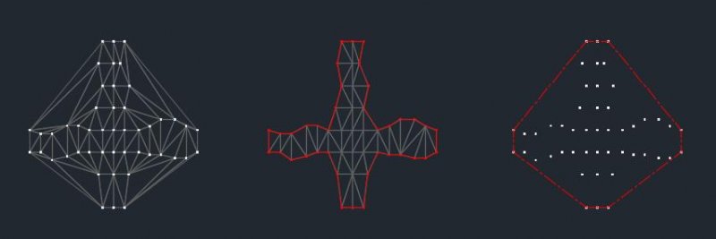

BIGAL
You are correct Marko the issue is to do with what we call long triangles have a look at this image, left is as built right is after edits and has the correct boundary.
Looking now 3 mistakes ? Need to fix and redo, these were little tiny slivers so the correct answer is both concave and convex, then LINEWORKSHRINKWRAP. We use delete long triangles via a length factor reducing till we start erasing ones we need then it becomes maual edits. I have been told we may have a 3rd party solution from our surveyors.
left after create triangles, middle is correct answer, right is convexhull.lsp

zixuan203344
it is a good solution For equidistant point sets or approximate equidistant point set
