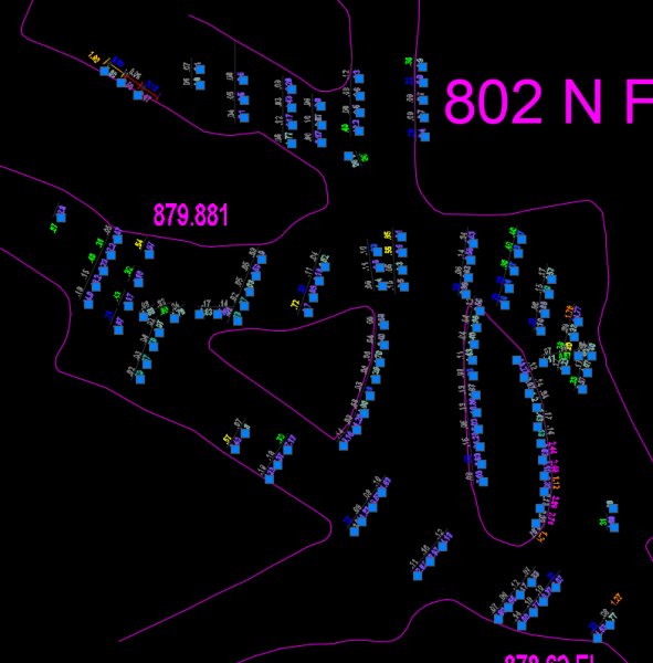

is it possible on autolisp to select all text below the line? we always deal with data like these, and I'm just thinking maybe i could ask your help if it is possible to select all text below a line...
BTW, the dxf/dwg files are always in clockwise, and due north(270)
and all lines starts from north going down, so that all angles will never be GREATER THAN 270 OR LESSER THAN 90
i attached a sample dxf and that is just a tiny portion, does anyone know a way?
new block.dxf

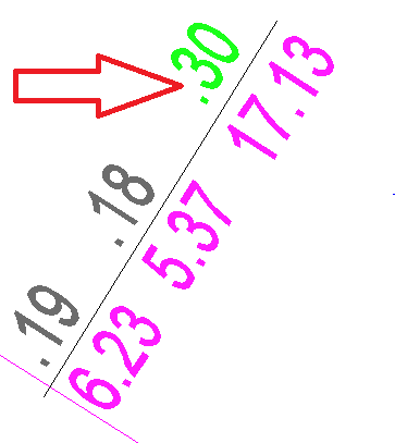

In what form should the final result be?

maratovich
Check this out:
Share this post
Link to post
ktbjx
Check this out:
o you mean which are the ones i need to select?
its the texts below
no matter the orientation i need to select only the text below the lines
Share this post
Link to post
maratovich
Can not you see the red arrow?
Check the selection ".30 / 17.13"
Share this post
Link to post
