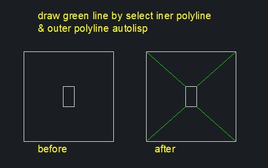

draw green line by select inner polyline & outer polyline
Biswanath Das
Do you really need a sample ? Just make something, use compare distance of co-ords should work with object1 object2.

@BIGAL
If you select the inner pline first and that pline is much smaller than the outer one, and tucked into one of the latter's corners, the result of your code is not as intended. Also your code does not take the OSMODE into account.

Roy we can only make an educated guess based on what is 1st provided, you are right that we dont know what the end user is going to throw at it. placing a rectang into a corner may not be the case I tried a inner pline on an angle and it really screwed up. You are right often osmode 0 is required but the image suggested it was not required. Similar with Lee's examples

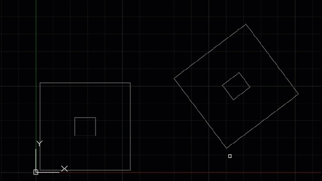

Here's another to do one at at a time rotated or not.

Try the following for rectangles at any rotation & orientation:

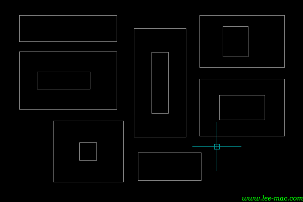

On 10/14/2018 at 4:26 PM, Lee Mac said:

Lee, this is not always enough to test for rectangles. Try on a polyline passing these vertexes: ((0 3) (10 3) (9 6) (1 0)). This shape will also pass the angle test
(or (equal a 0.0 1e-8) (equal a (/ pi 2.0) 1e-8))
I remember a discussion on The Swamp about regtangle-p lisp, but I don't know if there is a conclusion there.

Good counterexample Stefan.
I've also realised another issue with my current algorithm...

I think the following should solve this issue -

I omitted the test for orthogonality with the coordinate axes, as this is a special case.
