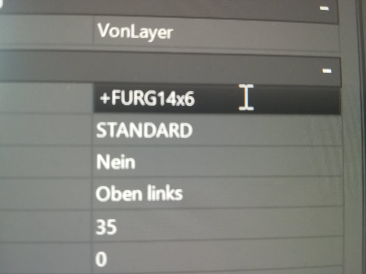

Well, as the title says, when I want to edit any value, or add one in the properties palette (CTRL + 1), for ex. Text Override in Dimensions, the moment I click in the field, the vertical typing cursor should appear and start blinking. Well, it doesn't... I have searched Google etc., tried to fix it in windows settings, but with no success.

I click on any editable field twice, and no blinking cursor appears. The picture was taken after the doubleclick.

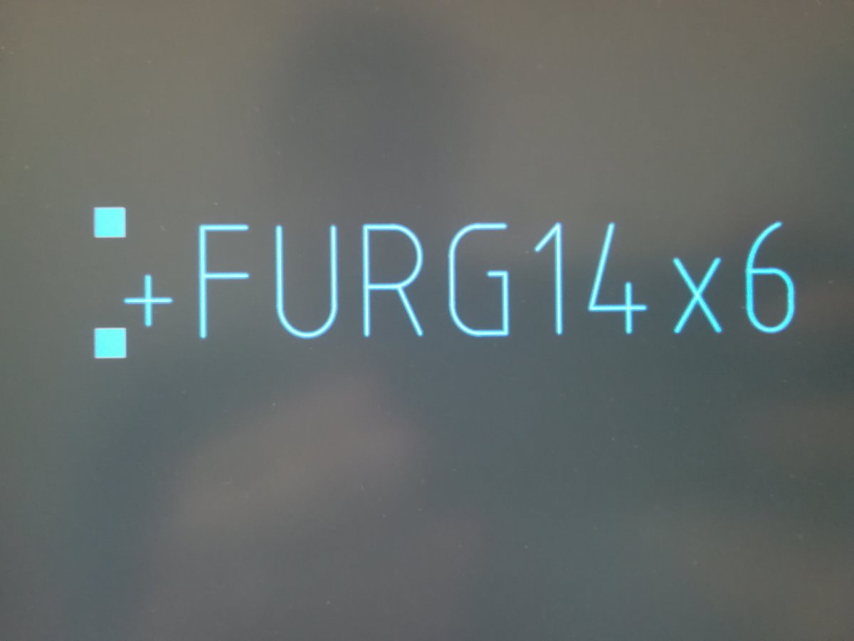

The pictures are showing the situation; I select some text, or a block, and when I try to edit it via the properties palette, no blinking cursor...
