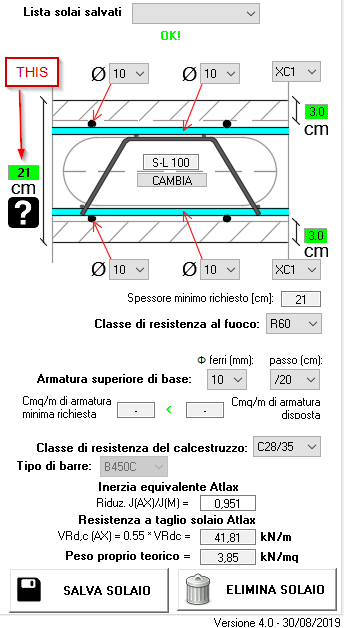

Can you post a screen image of what the (dcl-Control-GetText Pipp/Main/h) looks like had a quick look at opendcl and understand its 3 parts.
Edited by BIGAL
Share this post
Link to post
MastroLube
I get "21" from textbox in my interface :) It' the high of my slab.
When I press to "SALVA SOLAIO" I  save all these values in my dictionary.
