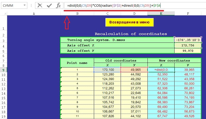

This program moves and rotate selected objects according to the example of a standard autocad command align.
But I have a different task, I need to recalculate the coordinates of the point.
Knowing the angle of rotation and offset along the axis X and Y.
I tried to do it myself:
(defun get_baz_line ( / ang )
(setq p1 (getpoint "\nSpecify first point  ->>"))
(setq p2 (getpoint "\nSpecify second point ->>"))
(setq ang (angle p1 p2))
ang
(setq ang_1 (get_baz_line)
      XY1_1 p1 ; The first coordinate of the baseline
	  XY2_1 p2 ; The second coordinate of the baseline
	  ang_2 (get_baz_line)
	  XY1_2 p1 ; The first coordinate of the new line
	  XY2_2 p2 ; The second coordinate of the new line
	  Dif_ang (- ang_2 ang_1); ANGLE for recalculating point coordinates
(setq delta_X (-             ; Offset by axis X
                 (car XY1_2)
					    (* (car XY1_1) (cos (atof (angtos Dif_ang 3 4))))
						(* (cadr XY1_1)(sin (atof (angtos Dif_ang 3 4))))
						); end of setq
(setq delta_Y (-             ; Offset by axis Y
                 (cadr XY1_2)
					    (* (car XY1_1)(sin (atof (angtos Dif_ang 3 4))))
						(* (cadr XY1_1)(cos (atof (angtos Dif_ang 3 4))))
						); end of setq
And here I am stuck....
I can not understand what's next.
I tried to repeat the formula from exel (watch attachment), but I could not get the correct data.
If anyone can help with advice, I will be very grateful.
Thank.

hanhphuc
EXCEL data in 2D try this sub - rectangular to polar coordinates
(defun r->p (v / a) ; v (x,y)
 ;2D Rectangular -> polar coordinates - hanhphuc
  (list (if (minusp (setq a (apply 'atan (reverse v))))
          (+ a pi pi)
          a
        (sqrt (apply '+ (mapcar '* v v)))
  ) ; angle & distance
;;;(rtd (car (r->p '(4 -3))))
;;;126.87
;;;(r->p '(1.0 1.0)) ;(0.785398 1.41421)
;;;(angtos (car (r->p '(3 4))) 1 4) ;"53d7'48\""
(defun dmstof (d m s / l) ;hanhphuc
  (setq l (list d m s))
  (if (vl-every ''((x) (and (<= 0. x) (< x 60.))) (cdr l))
    ((if (minusp d)
      (angtof
        (apply 'strcat
               (mapcar ''((a b c) (strcat (rtos (abs a) 2 c) b)) l '("d" "'" "\"") '(0 0 2))
;;;(dmstof -176 35 10.3)
;;;-3.08201
;;;(setq str (getstring t "\nDDD MM SS : ") )
;;;(apply 'dmstof (read (strcat "(" str ")")))
;example from your EXCEL sheet
(setq ; a ( angltof  '(-176 35 10.3) )
      a (dmstof -176 35 10.3) ;rotation ddd mm ss
      p  ' ( 172.756 99.97) ; axis offset XY
      op  ' (118.203 43.008) ; point#4= old coordinates XY
;usage:
(defun foo (p a op)
(apply 'polar (cons p (mapcar '+ (list a 0.0) (r->p op))
(foo p a op)
(57.3237 49.9997) ;point#4= new coordinates XY
Edited by hanhphuc
typo (r->p x) , dmstof

dilan
          (+ a pi pi)
          a
(defun angltof (l) ;hanhphuc
    ((if (minusp (car l))
      (angtof
        (apply 'strcat
;;;(angltof '(-176 35 10.3))
;;;-3.08201
;;;126.87
(setq a ( angltof  '(-176 35 10.3) ) ;rotation ddd mm ss
;usage:
(defun foo (p a op)
(apply 'polar (cons p (mapcar '+ (list a 0.0) (r->p x))
(foo p a op)
Thanks for the answer.
But I get an error: too few arguments
Found a reason:
(defun foo (p a op)
thank you very much for your help, hanhphuc
Edited by dilan
