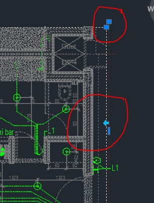

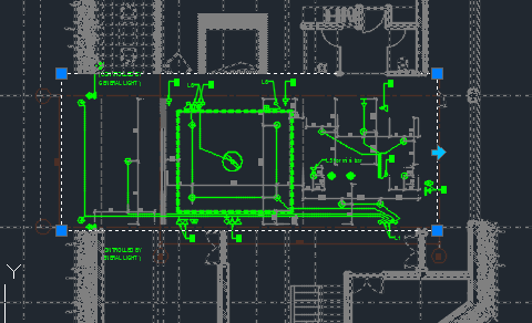

I have found a drawing that they have created a view port on moddle space. But it is a block. when I double click on view port boundary id display the outer part of view port. What is this function.

Take a look at the clip command
