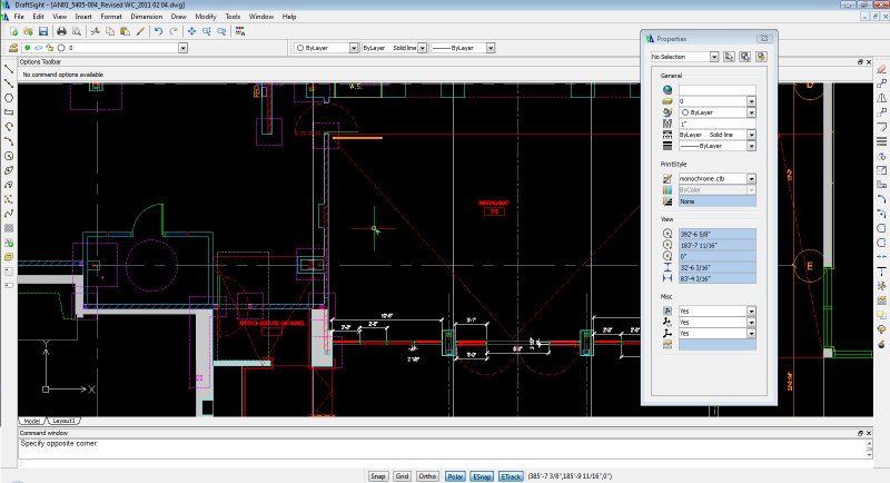

kencaz Posted April 3, 2011 Share Posted April 3, 2011 Dassault Systems (makers of Silidworks), has recently come out with an AutoCAD look alike they call "DraftSight" It is also Free... I have tried it and was really impressed how AutoCAD like, (well the old CUI), it was. I would certainly use it over DoubleCAD KC Quote Link to comment Share on other sites More sharing options...
