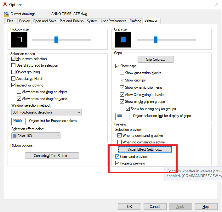

I see in AutoCAD MOVE one can see the moved object connected to the cursor while moving but not the moved from object.  Well, I can see the original image if I look really really close and strain my eyeballs until they almost explode. It is WAY fainter than it used to be, and WAY fainter than the original copied object too, which stays highlighted.  Are you sure it is not there at all?
I wonder if it is a layer transparency issue.  I see where transparency does lighten the ghost image of the original object significantly.

I tried the "selectionpreview" on the command line; values are 0-3. Tried them all with no effect. I did explore the layer transparency as well early on, no change that seemed to help. I think this drawing got corrupted somehow and I'm giving up on it. It was an evaluation drawing for material needs, none of the work is of major importance right now.
