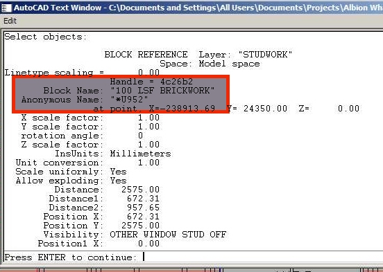

If you list the block does it show like this? my lists the block name and another anonymous name. My blocks are also Dynamic - this shouldn;t have an affect on your attribute extraction. :?
I can't seem to find the information that you provide through the text window, what kind of selection do you make to get the information?
