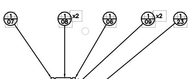

Hello guys,
Can some one please tell me what is indicated by those circles and number markings in the drawing. Sorry i can''t share the full picture but it is a box type thing
thank you.
There's no way to tell from an image. Could be fields, image frames, text frames, proxy objects, Revit artifacts, or a bug. And that's just off the top of my head.
There's a block or something that defines those section markers. I would look there first.
Without seeing more of the geomety it's almost impossible to guess.
But those look like callouts to a parts listing? (eg, Parts List 1, Items 6,7,8,9, & 23).
(or Assembly 1, Item details drawings 6,7,8,9, & 23).
Or possibly callouts to a sheet of machining/folding/other manufacturing details?
