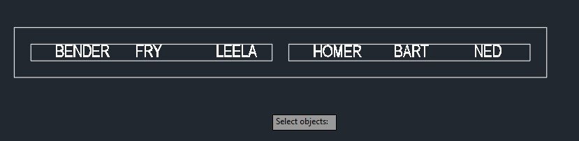

zachary.cowherd Posted February 9, 2022 Share Posted February 9, 2022 I am currently running Autocad 2022 and I am trying to export blocks via (ATTOUT) in the Express tools. I am selecting my blocks, typing attout and following the prompts to save the txt file. After I hit save it say "select objects:". It will then not allow me to select the blocks again. What am I doing wrong or missing? Quote Link to comment Share on other sites More sharing options...

zachary.cowherd Posted February 10, 2022 Author Share Posted February 10, 2022 The names are just place holders for the blocks. I have added the file to this reply. TEST.dwg Quote Link to comment Share on other sites More sharing options...
tombu Posted February 11, 2022 Share Posted February 11, 2022 There's 6 blocks in the drawing but none had attributes to extract. What did you want ATTOUT to do? Quote Link to comment Share on other sites More sharing options...
