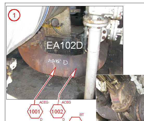

I need to place leaders, including a block (with attributes) over raster images (photographs). See the attached image for an example - I created this sample using:
1. A white-highlighted mulitline, so I could wipeout around the line for visibility
2. A white-highlighted arrow block
3. A balloon / block with multiple attributes
Now I need to do this a few thousand times. Can anyone suggest a better method, particually one that can eventually be programmed?

He is using multiline & wipeout to accomplish it as mentioned by him in his original post above

Can you make the hexagon and the arrow as a block? It will be a litle bit faster to insert in the drawing. If the arrow must be moved, it should be a dynamic block.
Attributes can be automated to contain sequential numbers -this subject was covered in the forum.
Oh, and the white "background" can be included too in the block.

Rather than creating a dynamic block, I'd recommend you create the hexagon and text as a block with attributes, and then use it as part of a multi-leader (MLEADER). As for the leader and arrowhead, adding a heaver lineweight to the leader and a filled arrowhead, instead of the wipeout may result in an overall cleaner look.

Yes, this is really ugly, but I need to consider the case where the field guys do not access to a color printer or copier. I could not find a lineweight/color combination that would work consistently over so many different colors and contrasts on the photos - every line combination I tried became invisible or poorly visible in B&W.
I initially tried creating a multileader w/user block + attributes for the hex, but since I could not find a workable line width & color combination it did not help. I am still using the hex block, and the values inside the block do auto increment via a lisp routine.
I understand that in 2010, multileaders will have "Per Segment Leader Properties", so it that happens, it may be possible to use a light segment over dark portions and visa versa. We shall see.
Regarding using a block as an arrow - I also tried that, but cannot get the arrow to run parallel to the multileader. Has anyone experienced that issue with custom multileaders?
