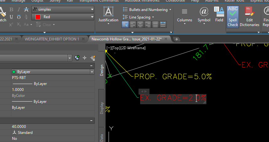

Rana Elhakim
3 hours ago, RobDraw said:
This is the one I am using attached below. Yes, I loaded it first. When I use it, it just doesn't do anything at all. in the command space, it says "StripmText Completed, objects processed" But nothing is changed . Also I uploaded a picture below showing what I was hoping to use the command for. i have so many mleaders whose colors are all already set "by layers", however they do not reflect the layer color. Then I find out the actual text in the text editor were all set individually to different colors. So I was hoping to use the stripmtext command to reset all the mleaders colors and properties. Please let me know what I am doing wrong or how can I make it work.

BIGAL
Lee-mac has a stripmtext try that or start with his string subst.lsp

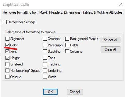

RobDraw
The LISP works. It's already in my toolbox. It must be doing something if you are getting the message.
Do you get the dialog box with the settings?
Do you have color checked?

tombu
On 1/25/2021 at 11:04 AM, Rana Elhakim said:
I have Autodesk Civil 3D 2019 and unfortunately the stripmtext command wouldn't work even thought I followed all the instructions. I am assuming it's because of the autocad latter version. Please let me know if you have an updated version, thank you!!
Newest version I know of was from 2010 https://www.theswamp.org/index.php?topic=31584.0
Hadn't used it in a while. After testing neither versions 5.0b or 5.0c would work in 2021.
Version 3.08 removed font and color changes but not strikethrough or leaders.😢

Rana Elhakim
BIGAL, could you explain more what you mean?
RobDraw, yes I get this toolbox and I do keep all the boxes checked, but nothing happens. Here is what I have in the command box.

Steve Doman
Hello
If you are having trouble running StripMtext in AutoCAD 2021, please verify you have installed the AutoCAD  2021.1 update that was released in August 2020.
This update fixes a bug in AutoLisp that broke the Vbscript RegEx object which StripMtext (and similar routines) use to find and remove formatting codes in a mtext.
if after verifying you still are having trouble, then let me know and I’ll look into it.

tombu
Thanks Steve!
Gotta wait on MIS to install the update for my 2021.1 but tried With the 2021.1 update both 2019 and 2021.1 are working perfect.

Steve Doman
You’re welcome Tom.
I forgot to say that if you are unable to install the 2021.1 update, then second choice is to set the AutoCAD system variable LISPSYS to zero and restart AutoCAD. The caveat is AutoCAD will then use the old VLAIDE rather than new Visual Studio.
