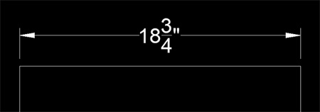

bizouman Posted August 8, 2010 Share Posted August 8, 2010 This is an old post but I would like to know how to display in inches with fraction.... Not 1' 6 3/4" I would like to display 18 3/4" the previous post is only working for none fraction number. Thank you Quote Link to comment Share on other sites More sharing options...
Cad64 Posted August 8, 2010 Share Posted August 8, 2010 It works for me. Did you set up your dimstyle exactly as I described in that old post? You don't have to set precision to 0 though. You can set it to any fractional amount. In the screenshot below, I have precision set to 1/4". Quote Link to comment Share on other sites More sharing options...
bizouman Posted August 8, 2010 Share Posted August 8, 2010 hoooo it's Sunday.... I left my brain a the office... sorry, I'm newbie !! LOL I red decimal, not frational now it's working !! thank you Quote Link to comment Share on other sites More sharing options...
