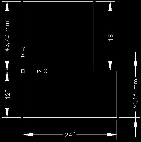

Hi,
if your units in AutoCAD are set to Architectural, create a new dimensionstyle where you use a Decimal Unit Format and add a Suffix ("). The result will be like this (The millimeter dimensions result in greating a Dimstyle where the Scale factor is set to 2.54 and the suffix to (mm)).
HTH
Petri
I do this by setting my dimension style to fractional and then adding the " suffix. The only downside I have found is if you dimension a radius you'll have to modify that particular dimension via properties.

Hi,
[ATTACH]3744[/ATTACH]
HTH
Petri

Hi,
HTH
Petri
I think that you have the factor wrong.
If you factor by 2.54 that should be "cm" instead of "mm". you need to factor by 25.4 to be "mm". or am I reading something wrong?
no you are correct it is 25.4 when on about mm to inches , check the exact factor because it can be different
