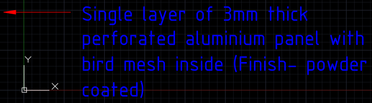

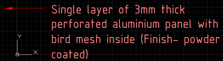

Hi,
Please check the attached drawing. I am not able to change the color of this particular Mtext using the routine.
Drawing1.dwg
2 hours ago, Ashishs said:
Hi,
@Ashishs Works for me as well as @SLW210 on your example drawing. I don't see any problem.
Below is the LSP I am using, which is not working on this text. Please let me know if anything is missing.
Is the text text or mtext rather than a part of a dimension, leader or qleader?
The routine I linked  back to was the one for texts/mtexts, why wouldn't you use that one?
Can't we combine both the routines so that with a single command any type of dimension (leader, qleader) and any type of text (text, mtext) changes to the specified color?
That is possible - a great learning opportunity... have a go and come back with any questions maybe?
