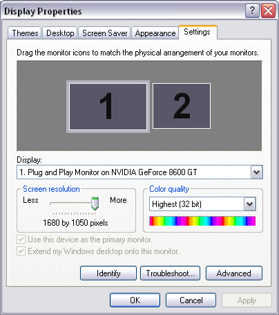

BEACHCOMBER Posted January 5, 2008 Author Posted January 5, 2008 I have tried moving the screen about but no joy yet. Is there any thing I can do to increase the range in which I can search for this 'properties palette box' which is off screen? Quote
Cad64 Posted January 5, 2008 Posted January 5, 2008 Were you using dual monitors before? If so, changing your screen resolution probably won't help. But if you haven't already tried this, go to your Windows > Control Panel > Display settings and set your screen resolution all the way up. Quote
James Posted January 5, 2008 Posted January 5, 2008 either try pressing ctrl+1 or you may need to do a repair for autocad. Quote
BEACHCOMBER Posted January 5, 2008 Author Posted January 5, 2008 I have tried increasing the resolution from the display panel but no joy yet. Thanks anyway Quote
