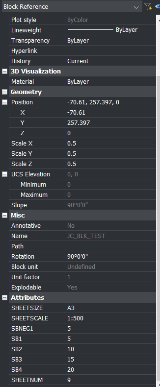

I think my confusion is that the object is listed as an attribute in the properties window, but is not actually an attribute at all. Maybe it's a tagstring?
I can see TagString = "SHEETSIZE" when using the dump, but cannot see any of the other listed values such as SHEETNUM or SHEETSCALE?
I'm not really familiar with how block references work >_<
because it's (car) https://help.autodesk.com/view/ACDLT/2024/ENU/?guid=GUID-2DD1AF33-415C-4C1A-9631-DA958134C53A
get first one for the sample.
