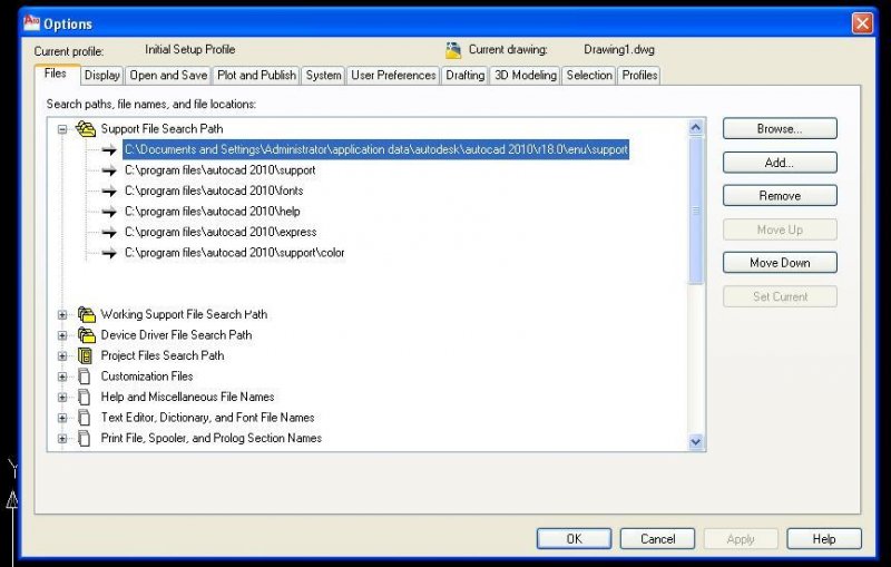

NoelStalker Posted November 4, 2008 Author Share Posted November 4, 2008 Ghost Rider I too am interested in using my acad.lsp file to load the lisps every time. I can't find it though. Quote Link to comment Share on other sites More sharing options...

GhostRider Posted November 4, 2008 Share Posted November 4, 2008 If your have searched and don't have one you can create it and place it in your search path. custom commands and lisp can be loaded all at once. There's alot of discusssion here about customizations if you search. I'm still learning myself.. Quote Link to comment Share on other sites More sharing options...
