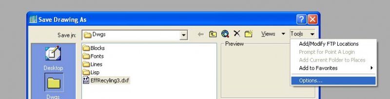

anyway, I think this is where you disconnect association of the MS and PS in dimensioning.

I believe (and I'm prepared to be corrected) that those settings don't have anything to do with breaking the association between MS & PS. In fact, I would say the opposite. These settings allow for dimensions placed model space to be shown at the correct scale when viewing in paper space.
hi Soleary, yeah will delete that coz ive just tried it. very curious though coz i could almost swear thats where we linked dimensioning of an MS object to PS when we were still using CAD2004. Back then when we dimensioned the PS distance is what shows, we toggled 'scale dimensions to layout" and it worked.
thing is its what OP is trying to accomplish here.
