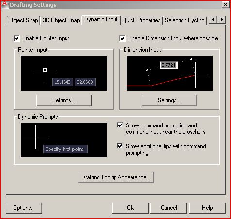

Renato - BR Posted March 25, 2015 Share Posted March 25, 2015 I have a doubt related to this topic. Could someone please explain why in my model is locked the box "type", on "adjust sun and sky background" window, so I cannot preview the changes I would like to make. The tips above did not help. Quote Link to comment Share on other sites More sharing options...
Cad64 Posted March 26, 2015 Share Posted March 26, 2015 Can you provide some more detail about the problem? Maybe even a screenshot to help us understand what's happening? I'm not sure I understand. Quote Link to comment Share on other sites More sharing options...
Renato - BR Posted March 26, 2015 Share Posted March 26, 2015 Hi, Find below, tx. Quote Link to comment Share on other sites More sharing options...
tzframpton Posted March 26, 2015 Share Posted March 26, 2015 You must be in PERSPECTIVE viewing mode for this to be enabled. Type PERSPECTIVE and set it to 1 and it will now be available. Quote Link to comment Share on other sites More sharing options...
Renato - BR Posted March 26, 2015 Share Posted March 26, 2015 It is already in PERSPECTIVE mode (1) but the box is not available. I tried several commands but did not succeed. Remark: the drawing is a model originally produced in ACAD 2012v. Could some settings be in conflict / blocked for ACAD 2015v ? Thank you for your support. Quote Link to comment Share on other sites More sharing options...
tzframpton Posted March 26, 2015 Share Posted March 26, 2015 Type SUNPROPERTIES instead of BACKGROUND. In Sun Properties, can you turn Status to ON and Status of Sky Background & Illumination to ON? Quote Link to comment Share on other sites More sharing options...
ReMark Posted March 26, 2015 Share Posted March 26, 2015 On the Sun Properties panel look for the heading Sky Properties. It's possible Status is set to "Sky Off". Reset it. Visualize tab > Sun & Location panel > Sun Properties click on the arrow to the right. Quote Link to comment Share on other sites More sharing options...
Renato - BR Posted March 26, 2015 Share Posted March 26, 2015 The status is “sky background and illumination”. Any of the three options releases “type” box. Thanks. Quote Link to comment Share on other sites More sharing options...
