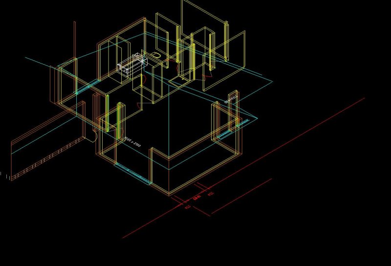

I don't quite understand what the final outcome looks like. Can you post an image? -David
absolutely. Here's hopefully what the final outcome will look like
