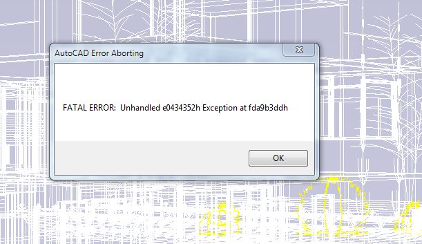

MikeP Posted May 5, 2011 Author Share Posted May 5, 2011 This is not the first time this has happened. Cad crashed... I have a autosave for every 5 min. But for this one drawing, there was no autosave created on the backup file window. and when I open the drawing in explorer. It opens blank. Now I know for a fact I saved this drawing. So how is this possible? Quote Link to comment Share on other sites More sharing options...

SLW210 Posted May 5, 2011 Share Posted May 5, 2011 This is not the first time this has happened. Cad crashed... I have a autosave for every 5 min. But for this one drawing, there was no autosave created on the backup file window. and when I open the drawing in explorer. It opens blank. Now I know for a fact I saved this drawing. So how is this possible? Now you see why many leave AutoSave turned off. Just rename your .bak to .dwg and you should have some of your drawing. Save, Save, Save, Save, Save, Save, Save, Save, Save, Save, Save, Save, Save, Save, Save, Save, Save, Save, Save, Save, Save, Save and Save. P.S. Did I mention SAVE? Quote Link to comment Share on other sites More sharing options...

MikeP Posted May 5, 2011 Author Share Posted May 5, 2011 Im almost positive the problem is the fact I get that "command is already in progress" and cannot save unless I close the drawings. Quote Link to comment Share on other sites More sharing options...
