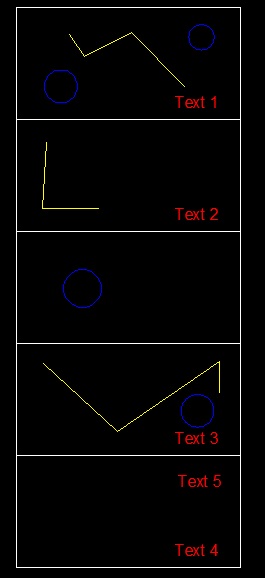

I am developing an application for AutoCAD, and need a routines in AutoLISP, or a SCRIPTs for autocad I do the following:
Select the entities that limit one or more Hatchs ...
Select a different entities with the line width greater than a certain value...

That's also not a line , it is a circle isn't it ?
yes. is this hatch limit of what I want to select
I believe he is wanting to select the hatch BOUNDARY.
He is also wanting to select all entities with a LINEWIDTH greater than a specified WIDTH.
