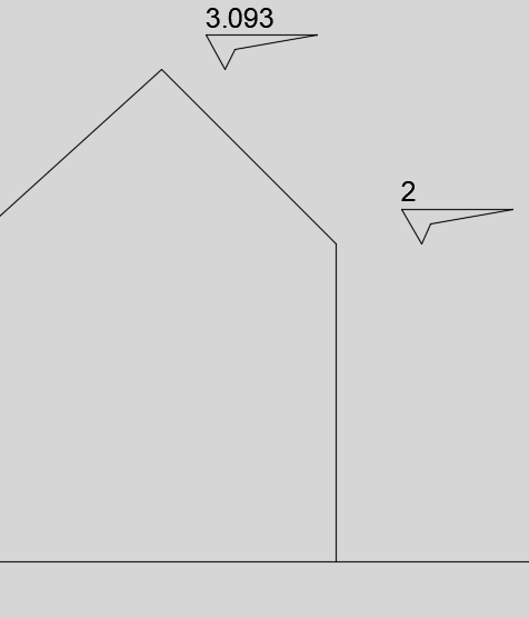

I am not sure if this is built into CAD or if I need a lisp. I would like to select a field that contains area information and have the object that is associated with that field highlight. The field is an attribute in a block. any suggestions?
