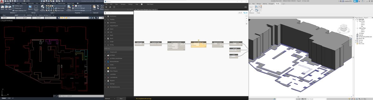

Hi everyone, currently I search for lisp that can convert objects into different layers, as shown in the picture, each polyline will be a layer, the layer is numbered from 1 to 255 with the corresponding color.
I searched but still have not seen so people have, please give me this lisp, because I changed manually for a long time.
Thank you

Does that mean there are supposed to be 255 polylines in total to be selected and changed? And does it matter which polyline ends up on which layer?

I think the reason is color. The layer number is the same as the index color. Here's a small routine to help you out.

Honestly, if you want to only change the colors of the lines, below is more than enough to do the job:
(vla-put-Color (vlax-ename->vla-object i) number)
or even (cons 62 number) is more than enough to do it.... much faster this way.
Anyway, as BIGAL points out, what are you trying to achieve in the end of this? Pretty sure there are more effective ways to get what you want other than putting each line in their separate layers.

Thanks Jonathan Handojo,
I need it because the node in dynamo requires separate layers to create a floor.
Can you handle the block?

If you're doing Revit, you're on the wrong forum my friend. But anyway...
If you mean selecting blocks too in addition to polylines, then:
