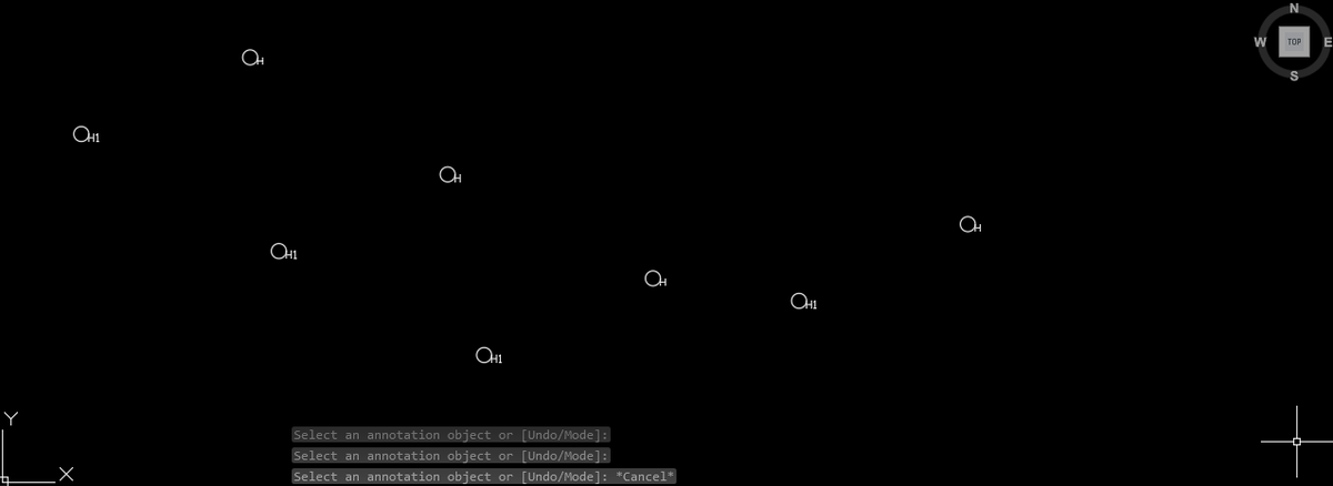

Dear friends,
I'm new here. But I'm tryin to combine AUTOLISP functions as ssget, assoc, enget etc to get a signle function , that will allow to select on one of the circles, press enter, and it will draw a polyline between circles that are located in the same LAYER.
Do you have any ideas?

I have 4 + 4 circles, they have layer 0 matched
But they have different text written nearby.
So I want to CAD recognoze the text and draw one PLINE between H, and another between H1
Thank you for your response :)
Could you perhaps post an image of the final result you're after?
Plus, it would be a lot easier if those were blocks whose attributes are H and H1 and the insertion points of the blocks are at the center of the circle.

It looks like circles with H1 or H next to them so that's ok and finding the circles is ok.
Now the problems are they always laid out like the image so the line joins left to right ? The biggest problem with auto can be the randomness of the circle positions.
Can you post a real dwg for testing.

Thank you for reply,
The thing is, that those "H" and "H1" are always on the same position relative to circles (let's assume it is 5 m to X and 5 m to Y). And finding circles with ssget is also OK. But for now I want just to CAD recognize the "TEXT" nearby circle and draw line between circles, which are marked with same text, so after I can figure out how to put them in the SAME layer and join those line into poly.
In addition, it is no problem which direction CAD will construct lines, since the point is to recognize TEXT nearby and use this constant, which I mentioned above to  put line into center of circle, I rather would say the circles don't need in that case, the main object is TEXT.

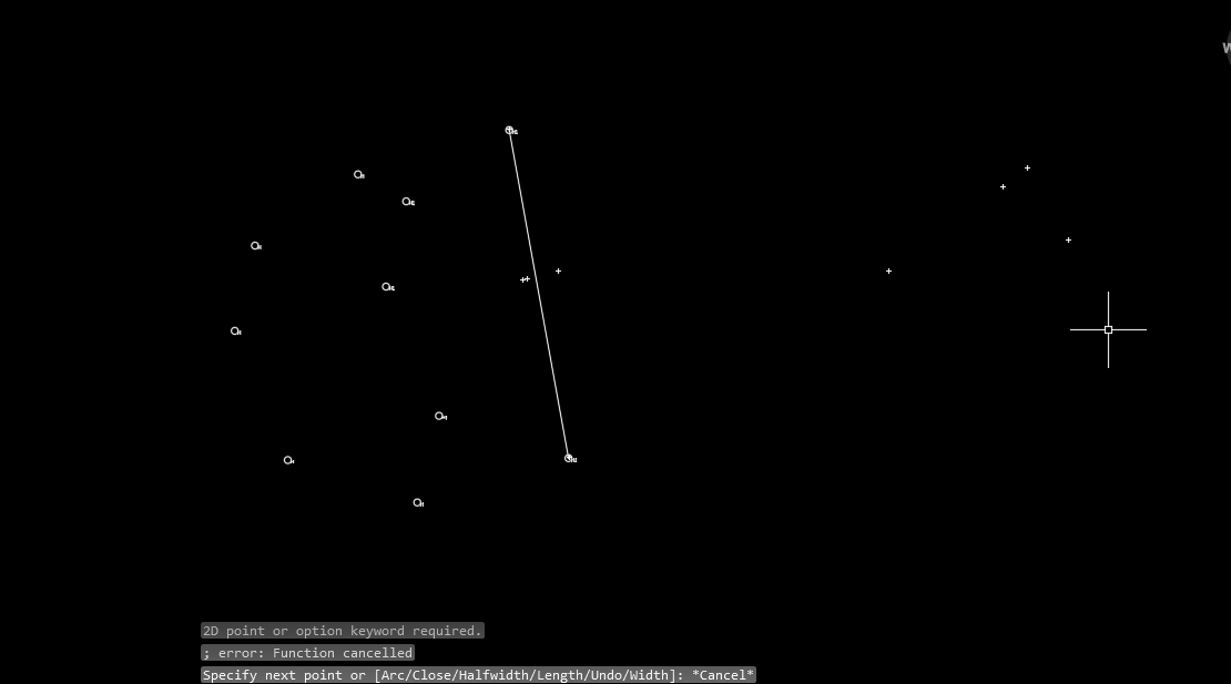

I actually have the example of code, since I'm not so good at LISP, so I study yet, I don't know such complicated LISPs, I used simple ones and I got result, but not what I expected, for some reason the "PLINE" command applies only to my last two circles ENDPOINT and STARTPOINT, but as seen from code it supposed to connect all 10 circles with single PLINE.
Code:
(defun c:PLtrace ()
    (setq list1 '()) ;create just list
        (setq circleset1 (ssget "x" '((0 . "CIRCLE") (8 . "mootmpunkt")))) ;select all circles (they should be 10)
            (setq circleset1length1 (sslength circleset1)) ; (checkin' how many circles in there
                (setq circlenum1 (- 1 )) ;variable for loop
                    (repeat circleset1length1 ;loop on selection set
                        (setq circlenum1 (1+ circlenum1)) ;new value of variable
                            (setq circlenames (entget (ssname circleset1 circlenum1))) ;get names of variable of set
                                (setq circlecoords1 (cdr (assoc 10 circlenames))) ;taking coordinates of centers of the circles
                                    (setq list1 (append list1 (list circlecoords1))) ; making list with those coordinates
                                        ) ;end repeat1
                                            (setq pl_com1 (- 1)) ;new variable for new loop
                                                    (setq pl_length1 (length list1)) ;length of list of coordinates list1
                                                        (repeat pl_length1 ;new loop
                                                            (setq pl_com1 (+ 1 pl_com1)) ;new value for variable inside loop, start point of PLINE
                                                                (setq pl_com3 (+ 1 pl_com1)) ;new value for variable ENDPOINT of PLINE
                                                                    (setq nomer_1 (nth pl_com1 list1)) ;taking out first element of list1, which is start point of pline
                                                                        (setq nomer_2 (nth pl_com3 list1));taking out first element of list1, which is end point of pline
                                                                            (command "PLINE" nomer_1 nomer_2) ; command pline which should take nomer1 nomer2 values to make pline
                                                                                ) ; end repeat2
                                                                                        ) ;end defun

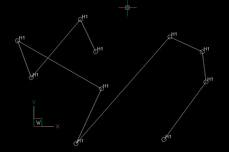

Something like this?

The task is not that hard but again the randomness of how the dwg was put together will determine how the pline is drawn.
My attempt
; simple join circles next to text.
; by Alan H April  info@alanh.com.au
(defun c:toff (/ CEN CO-ORD ENT INS LAY LST OBJ OBJ2 OFFD OLDSNAP RAD SS SS2 STR X)
  (setq offd 0.1)  ; change to (setq offd (getreal "\nEnter offset")) if text is further away
  (setvar 'osmode 0)
  (setq ent (entget (car (entsel "\nPick text for layer and value"))))
  (setq lay (cdr (assoc 8 ent)))
  (setq str (cdr (assoc 1 ent)))
  (setq ss (ssget (list (cons 0 "*TEXT") (cons 8 lay) (cons 1 str))))
  (setq lst '())
  (repeat (setq x (sslength ss))
    (setq obj (vlax-ename->vla-object (ssname ss (setq x (- x 1)))))
    (setq ins (vlax-get Obj 'insertionPoint))
    (setq rad (* 1.5 (vlax-get Obj 'Height)))
    (command "polygon" 20 ins "I" rad)  ;Autocad
    (setq obj2 (entlast))
    (setq co-ord (mapcar 'cdr (vl-remove-if-not '(lambda (x) (= (car x) 10)) (entget obj2))))
    (command "erase" obj2 "")
    (setq ss2 (ssget "F" co-ord (list (cons 0 "Circle"))))
    (setq cen (vlax-get (vlax-ename->vla-object (ssname ss2 0)) 'center))
    (setq lst (cons cen lst))
  (command "_pline")
  (while (= (getvar "cmdactive") 1)
    (repeat (setq x (length lst))
      (command (nth (setq x (- x 1)) lst))
    (command "")
  (setvar 'osmode oldsnap)
Edited by BIGAL
  • Thanks 1

Try this mishmash of routines. I've tried it in a dozen scenarios and point configurations and it seems to work, but I have a feeling I'm missing a case where it might fail.
(vl-load-com)
(defun rh:emLWP (lst cls)
  (entmakex (append (list '(0 . "LWPOLYLINE") '(100 . "AcDbEntity") '(100 . "AcDbPolyline") (cons 90 (length lst)) (cons 70 cls))
                    (mapcar (function (lambda (x) (cons 10 x))) lst)
            );end_append
  );end_entmakex
);end_defun
(defun rh:mslen (ent / sp ep obj vlst lst msl)
  (setq sp 0 ep (vlax-curve-getendparam ent) vlst (mapcar 'cdr (vl-remove-if-not '(lambda (x) (= (car x) 10)) (entget ent))))
  (while (< sp ep) (setq lst (cons (list sp (- (vlax-curve-getdistatparam ent (1+ sp)) (vlax-curve-getdistatparam ent sp))) lst) sp (1+ sp)))
  (setq lst (reverse lst) msl (vl-position (car (vl-sort lst '(lambda (x y) (> (cadr x) (cadr y))))) lst))
  (while (not (minusp msl)) (setq vlst (append (cdr vlst) (list (car vlst))) msl (1- msl)))
  (entdel ent)
  (rh:emLWP vlst 0)
);end_defun
(defun _gp ( lst / sp cnt d n z )
  (cond (lst
          (setq d (distance (car lst) (cadr lst)) sp (car lst))
          (foreach x (setq z lst) (foreach y (setq z (cdr z)) (if (< d (setq n (distance x y))) (setq d n sp x))))
          (setq lst (mapcar '(lambda (x) (reverse (cdr (reverse x)))) lst))
          (rh:mslen (rh:emLWP lst 1))
  );end_cond
);end_defun
(defun c:test ( / ss cnt ent elst ipt h_lst h1_lst)
  (setq ss (ssget '((0 . "TEXT")(8 . "Punkti_kood"))))
  (cond (ss
          (repeat (setq cnt (sslength ss))
            (setq ent (ssname ss (setq cnt (1- cnt)))
                  elst (entget ent)
                  ipt (cdr (assoc (if (and (= (cdr (assoc 72 elst)) 0) (= (cdr (assoc 73 elst)) 0)) 10 11) elst))
            );end_setq
            (if (= (cdr (assoc 1 elst)) " H") (setq h_lst (cons ipt h_lst)) (setq h1_lst (cons ipt h1_lst)))
          );end_repeat
  );end_cond
  (foreach x (list h_lst h1_lst) (if x (_gp x)))
);end_defun
  • Thanks 1

@ojacomarket Have you seen THIS  thread? Here's a quick modification to connect circles, blocks and points:
(defun c:path (/ _daisychain p pt pts s x)
  ;; RJP » 04.09.2020
  (defun _daisychain (pt l / tmp out dsort)
    (defun dsort (pt l / d1 d2)
      (vl-sort l (function (lambda (d1 d2) (< (distance pt d1) (distance pt d2)))))
    (setq tmp (dsort pt l))
    (while (setq tmp (dsort (car tmp) tmp)) (setq out (cons (car tmp) out)) (setq tmp (cdr tmp)))
    (reverse out)
  (cond	((and (setq p (getpoint "\nPick a point to sort from: "))
	      (setq s (ssget '((0 . "insert,circle,point"))))
	      (setq s (vl-remove-if 'listp (mapcar 'cadr (ssnamex s))))
	      (setq pts (_daisychain p (mapcar '(lambda (x) (cdr (assoc 10 (entget x)))) s)))
				 (assoc 8 (entget (car s)))
				 (cons 90 (length s))
				 '(38 . 0.0)
			   (mapcar '(lambda (x) (cons 10 x)) pts)
			   (list '(210 0.0 0.0 1.0))
(vl-load-com)
  • Thanks 1
