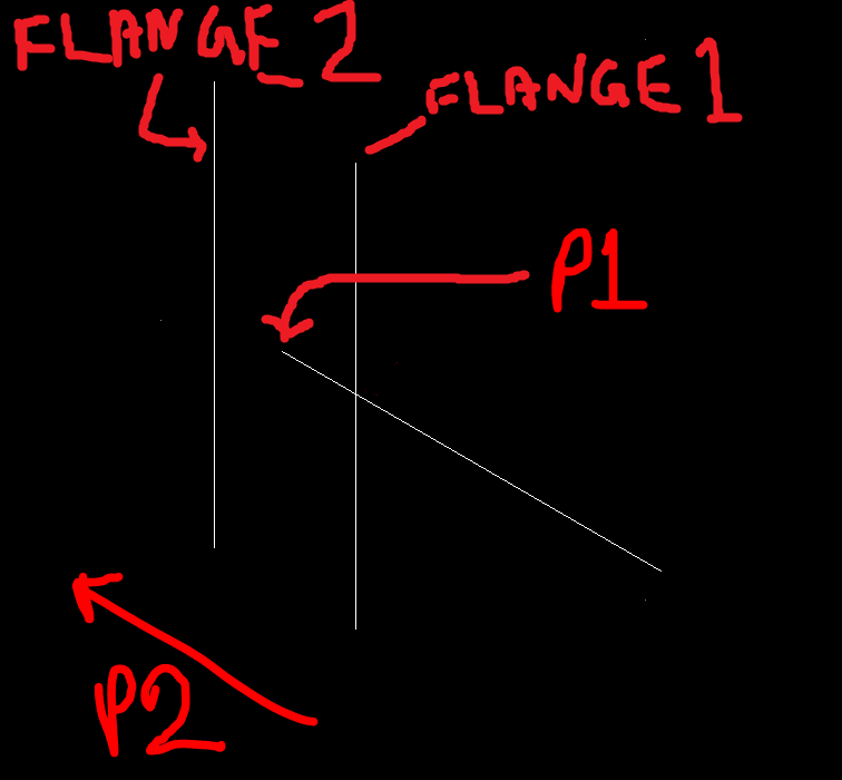

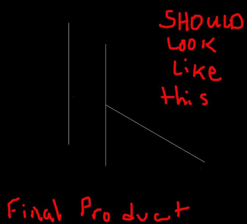

Hey guys I have a lisp routine to draw "flanges" for isometric piping. Basically drawings two lines that are a specific length and distance apart. The lisp prompts user for initial point(P1) then direction of flanges(P2).

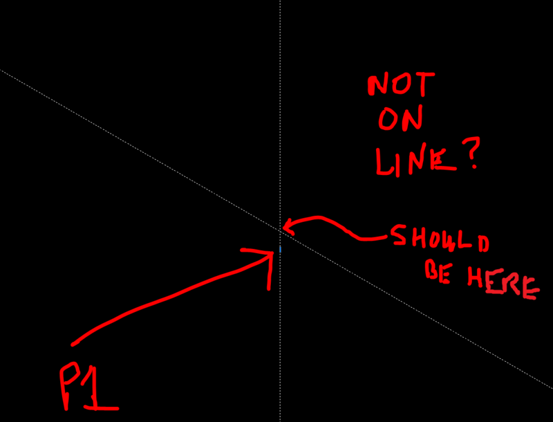

The problem I am having is for some reason I cant figure out why the flanges are centered around Point 1 instead of the first flange (line) being at P1 and the second flange (line) being at the specified distance in the direction of P2. check it out, run a test and report back if you can. I would love to learn the way to tweak this for future encounters with the same issue. See photos also.
Thank you in advance. Please let me know if I can assist in any way.
