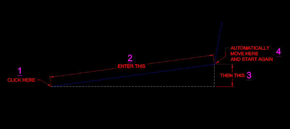

What I would like to do is start a line then, enter the second set of points but based on the location of start point?
What I need is to enter and draw the hypotenuse, by entering the hypotenuse length and the rise of the triangle.
The lines could be any directions but the "rise" will always be smaller than the base.
If possible the routine would find the direction of the offset so I don't have to enter the sign (+ or -)
The end result will be a closed shape.
Thanks In advance
I'm still not good at explaining.
I need to draw Line 2 from entering 2 and 3 based from the start point

A bit basic but it works OK, you might want to look at the loop and options to continue with the next line segment or end the lines there, a check that the supplied distances are valid (triangles... can it be made up), and also a check if hypotenuse distance added is +/- to draw the line left or right.. nut this is the basics - will leave it up to you to change or ask for more details and help

Something like this? I don't know about the one between 45-90 because your OP mentioned "rise", so I'm not sure what you mean.
